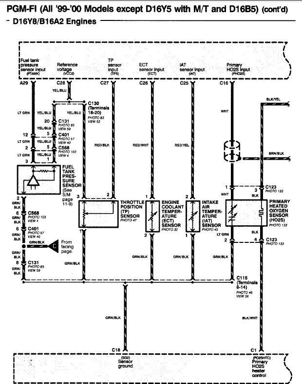

Default re: 99 civic EX - primary O2 SENSOR is missing
Originally Posted by N1YDP
i will have to look.all the pictures i have seen the primary was in the manifold.i know there is one back by the shifter.they put a catback system on it to.
The location of the stock 99 Civic EX primary sensor is as shown in the picture. Why do you think you need an O2 sensor? Is a code thrown?
The secondary sensor inserts into the cat.
Old 02-22-2015, 06:54 AM
Former User's Avatar
Join Date: Feb 2008
Posts: 45,219
Received 43 Likes on 21 Posts
Default Re: 99 civic EX - primary O2 SENSOR is missing
You can identify the connector for primary sensor by the color of its 4 wires:
Blk/Yel, Wht, Grn/Blk, Blk/Wht

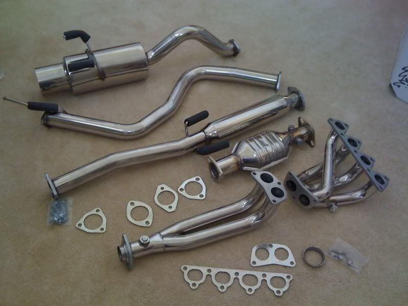

Old 02-22-2015, 06:59 AM
N1YDP's Avatar
Join Date: Feb 2015
Posts: 8
tis is what is on it minus the cat.
Try to locate the sensor connector in the area I mentioned.
found it.thanks.now i have to order a o2 with a female end.the one o got was a male.and to get the idle surge fixed.i amagine iac valve
