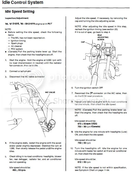

well i pulled a few threads.. check these out.
P0505 IAC (Idle Air Control) System Malfunction
