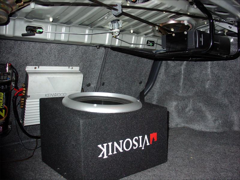

Put it in the trunk - that's what I did!
I put all that audio junk back there...
'99 Si CD Changer in '98 HX Trunk

nice setup. but i still need to figure out whether i can install the SI player into my 96-98 civic without modification.
and how the hell do you get 40+mpg with a b16
