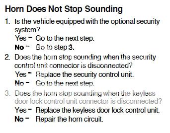

From what you have written above, the problem is the keyless system built into the stock radio not the security control unit, right? See diagram I posted above.

Did the unplug tests point to a bad security unit or radio/keyless unit? For the latter, you should be able to use a radio out of any 96-98 Civic EX or LX. Just swap your security unit into the slot on the top of the replacement radio.

The security unit, which fits into a slot on top of the radio, has its own connector. The radio has two connectors, one for the radio itself and one for the keyless system. If you read the troubleshooting diagram I posted, you'll see that if the horn stops sounding when the keyless connector is unplugged, then the radio/keyless system is the problem.

Ok, so just got my dash disassembled again so I could check at which point the alarm will sound, and when it will go off. When I hook up both connectors to the radio portion...nothing. When I hook up the connector to the Security Control Unit, the alarm starts going off. When I disconnect the Security Control Unit, the alarm stops even though the radio is still connected. So, according to your chart from earlier, the security control unit needs to be replaced.
