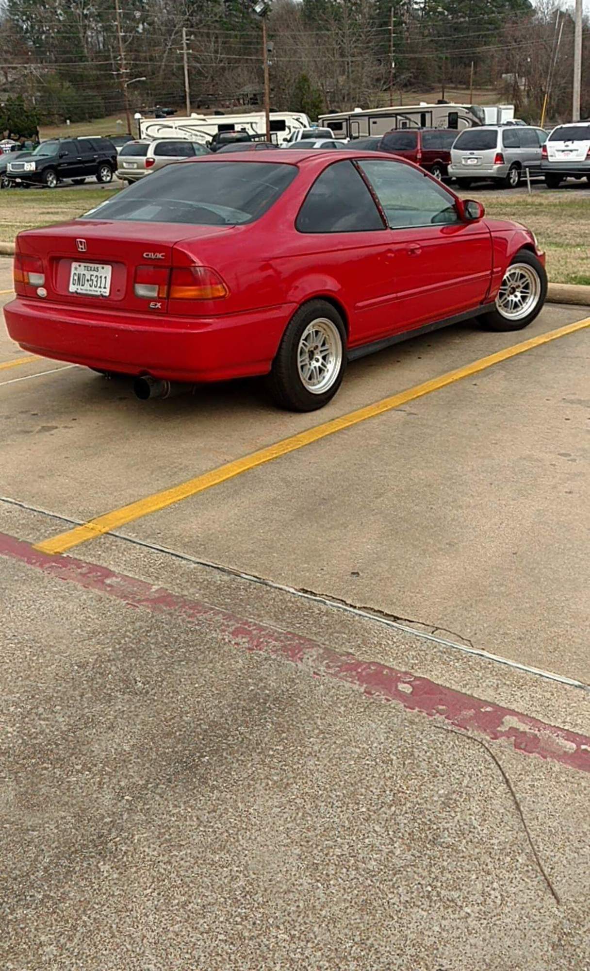

So I bought the coupe for $600 with the intention of buying and selling.... Things didn't go as planned because it's been a few years since I've had anything quick. My last car was a 2010 WRX that ran a 12 flat quarter mile.
Well, I had quite a bit of turbo bits laying around so the car got backed into the shop to change out a shot steering rack and things went haywire.
It's definitely a 15ft car. Has whiskey dents all over it and the car came from New York, it's got rust here and there.... It had no interior besides dash, front seats, and door panels, so I went to the junk yard and got some carpet, back seats, and a few pieces of trim for $75.
I put manual rack in the car as well as a solid rear shifter mount and poly front as well as rebuilding the shifter.

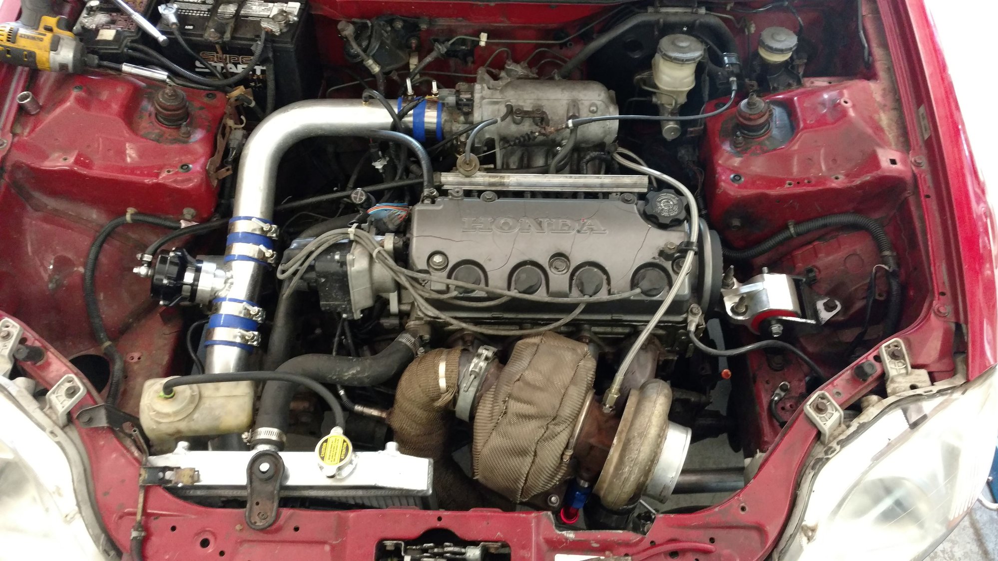

On to the fun stuff, the turbo is an HY35 off of my Cummins, tial BOV, turbo smart 38 EWG, vibrant 550 intercooler, SPA top mount. Just trying to get this setup running, then I'll be putting a p28 in along with some vitaras. I'm also looking at an LSD for the trans.
Also, I know the welds look a little rough. I ran out of 1/16 wire and tiger pawed down a piece of 1/8 Tig wire and welded it up with my sa200. That machine isn't exactly meant for fabbing small pipe. Down pipe will be getting wrapped and turbo has a blanket in the mail.

So I got the Keller exhaust mocked up. Going to have a go at it with some 3/32 6013 rods and see if I can weld it up.
Also picking up my turbo blanket and header wrap this evening. P28 with basemap, AEM boost and AFR gauge, and cluster bezel are in the mail as well as a Hallman Pro MBC. More pics to come tonight, hopefully.

Got my downpipe wrapped and turbo blanket on as well as most of my kteller exhaust welded up tonight. Going to add vband flanges to the part right before the lower control arm and go from there. Also got my oil drain JB welded onto my pan. Not real proud of that, but I don't have a way of welding aluminum sadly.

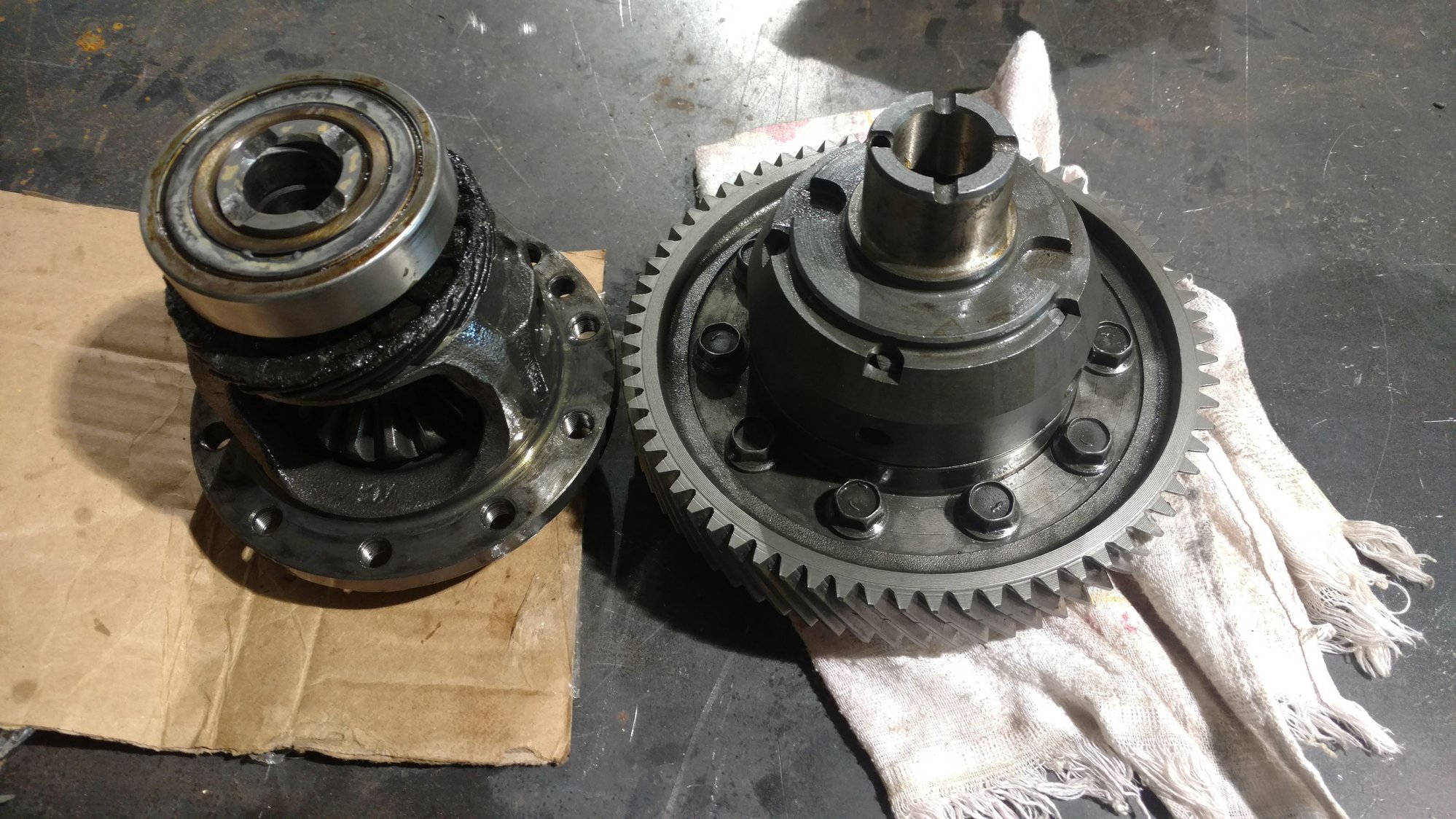

Also, scored a good deal on an OBX differential. Been sitting on a shelf for a while but brand new. Going to pull it apart and do the magic stuff to it and make sure it's right and run it.

Started doing a diff swap as well. Been waiting for over a week for the vss ring to get here...

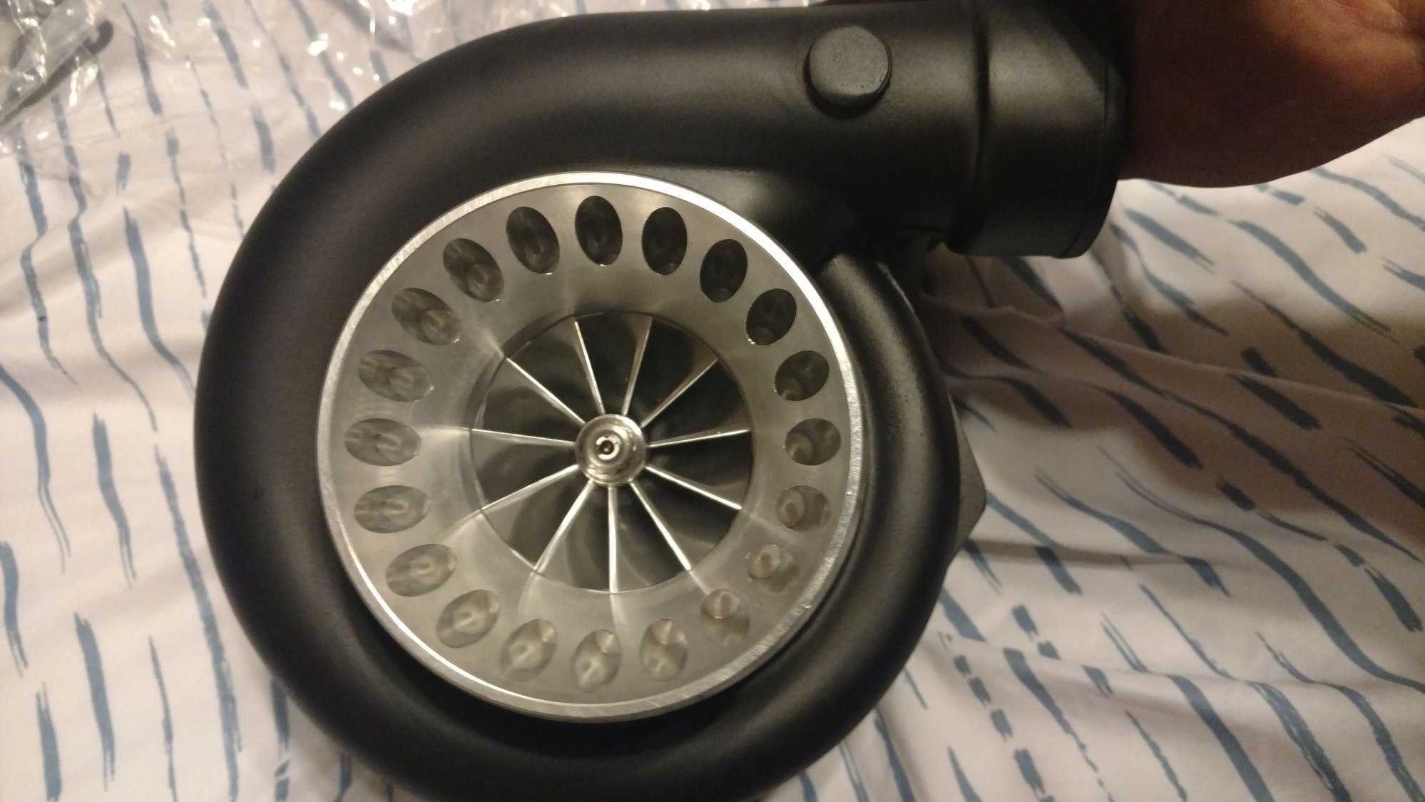

Well.... This showed up. BB 6262 from boostlab! Pretty awesome and nice guys. Took time to talk to me and help me out.
