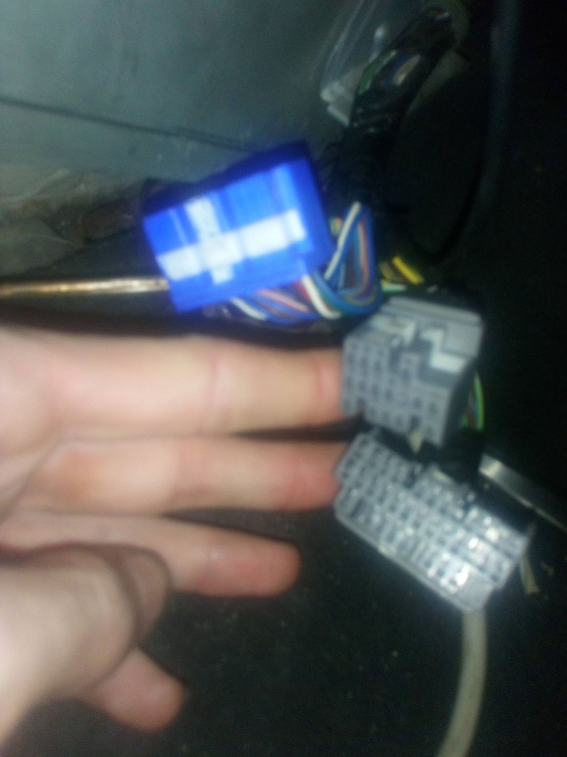

obd2a ecu? honda didn't make the em1 until 99-00 buddy. Please show pic of ecu

i will take out the ecu tomorrow if need be?sorry couldnt get a great shot from the botom of the ecu

pic are finally up

see my attached pics bud. pretty sure its obd2a
