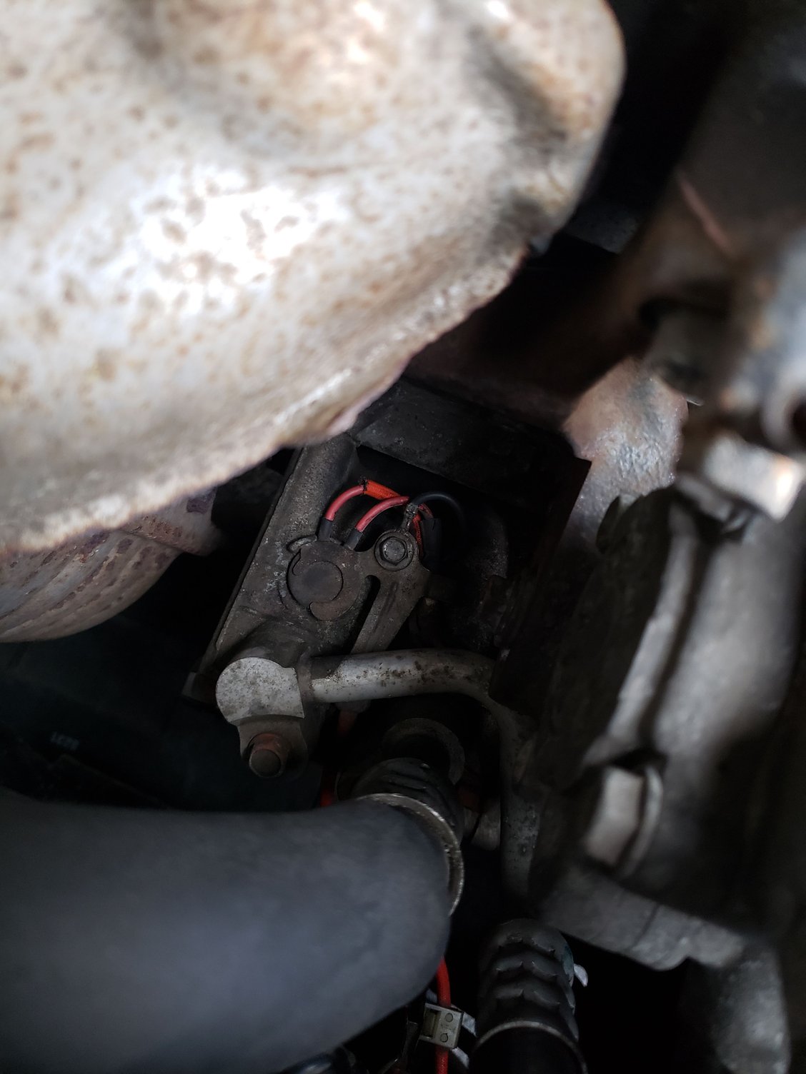

I'm having trouble tracking down the wiring for the compressor clutch. I disconnected the two harnesses in the first photo, but this cut power to the condenser fan. Is there a harness for the compressor? The only wiring I could find appears bolted to the top of the compressor (I see the red wire on the bottom right of the second photo, but I'm not sure where it goes). What am I missing? I'd like to make sure that there is continuity to the compressor clutch.
Also, the compressor clutch/condenser fan fuse now blows immediately when I try to turn on the AC. Is this still consistent with a bad compressor clutch? Could it be a bad compressor? When I try turning the clutch plate with my fingers when the car is off, I can turn the plate. I ordered a new compressor clutch and would like to install it on Sunday, but I'd like to make sure I'm not missing anything obvious.

follow that red wire

Should I be able to find the harness from the top of the car?

I do have voltage at the harness leading to the compressor.

unplug the compressor harness, start car and start ac. Does it still blow a fuse?
Old 09-02-2018, 08:33 AM
avinoam83's Avatar
Join Date: Aug 2018
Posts: 48
Default Re: 96 Civic Sedan - AC Condenser/Compressor Fuse Keeps Blowing
No. I'm in the middle of swapping clutch, just trying to get plate and pulley off.
