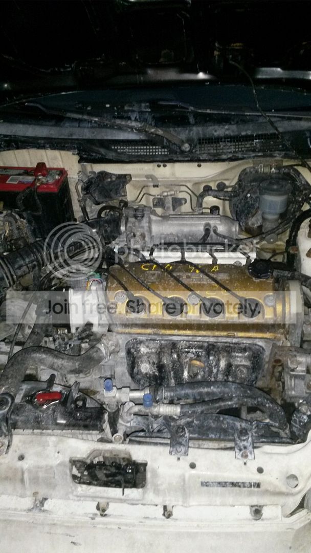

Hello. Seeking to make a thread about my not-running-properly.. car. Is a 1995 EJ1 Auto made in Canada.. but does NOT have a D16Z6. After perusing threads, I saw where to look. And I have:
So, that was a new discovery. I changed spark plugs and wires and the car always does the same thing: Randomly stalls immediately losing power, starts back up shortly after depressurizing cooling system with the safety valve on the aftermarket radiator cap.
Car appears to have an exhaust (?) leak in Cylinder 4, closest passenger side. This by pulling plugs after shutdown. That cyl is only one with misty vapor in it.

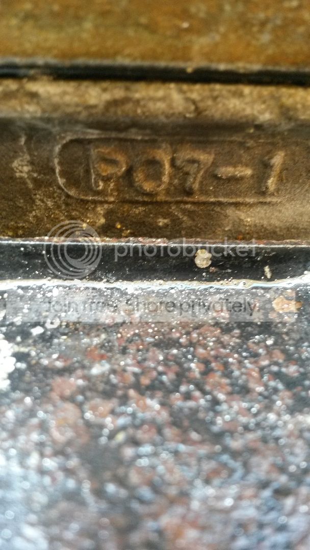

Head code seems to be P07-1?

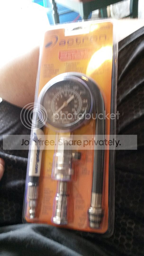

As to "Compression tester." Maybe I will just buy one. Am paying for my Lisle spill-free funnel.. let me see if I can get a compression tester as well. There is a hardware store down the block, but I want to continue to amass my own arsenal of tools.

head codes

I bought

There are no returns on that compression tester and I think I need someone to turn the key while I take the reading? .. What I am doing right now is watching Youtubers as to a "wet" vs "dry" compression test, to see if I need a second person.

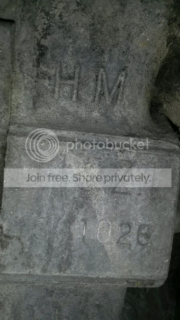

This is incorrect, D15Z1 is the LX engine (1.5L) and as I go to check head codes (it's not a P2J! Someone here was wrong! Can happen, it's all good,) I will proceed with engine/car tests as I learn how to perform them and your snarky quote should be the last.
back on track.. I think previous owner may have chose D15Z1 block because "It is still VTEC" and I get the very basic of one of the kinds of VTEC. Again.. learning. (When I first got my car, I thought it had a weird transmission problem. Turns out it was VTEC. Hasnt done VTEC in awhile.)

Got the compression tester,

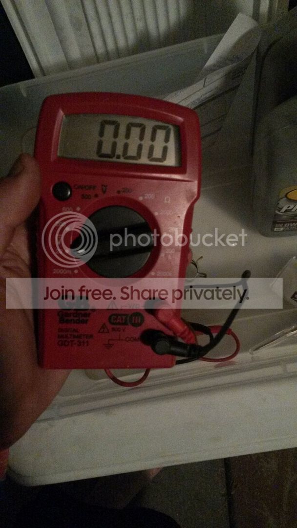

^^ I actually suspect that I may have fried the coil.. I am going to re-watch the video on distributor/coil test (also "Igniter") as well.
I had dizzy cap off.. no oil at all. Now to see how to do the test.. again, I think I need someone to crank it!

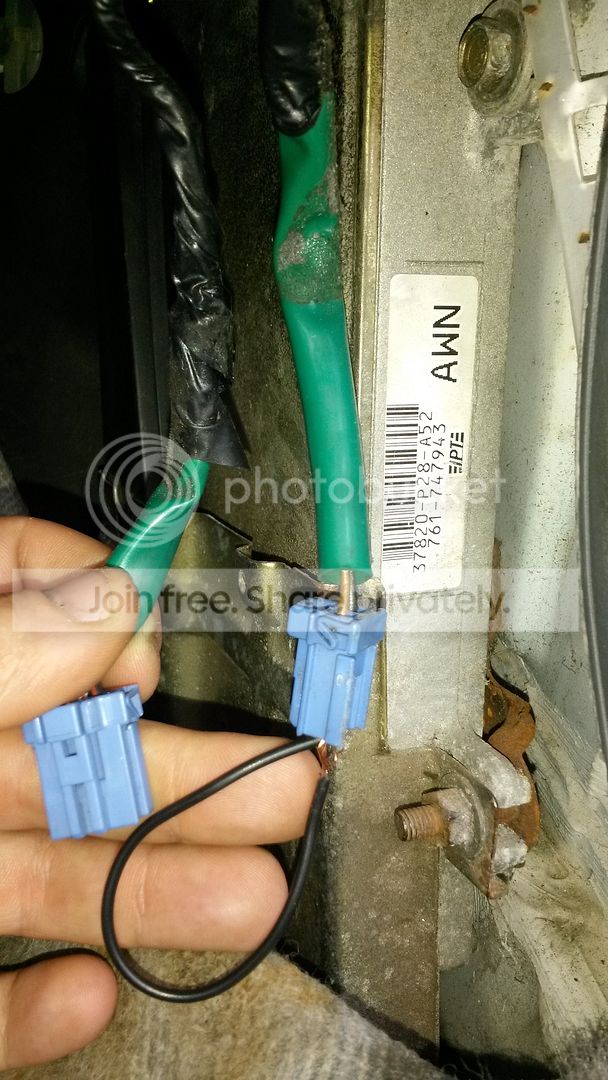

Is this the ECU? What else do I disassemble to see?

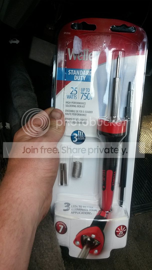

And.. Now, we should be all caught up.
Came back with the compression tester.
Going for soldering iron now.
Progress!
