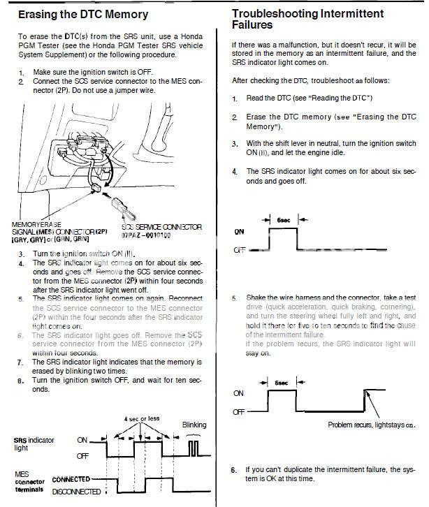

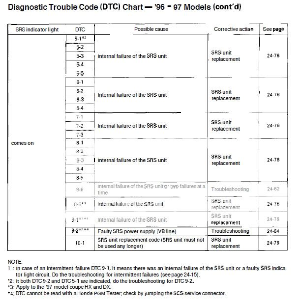

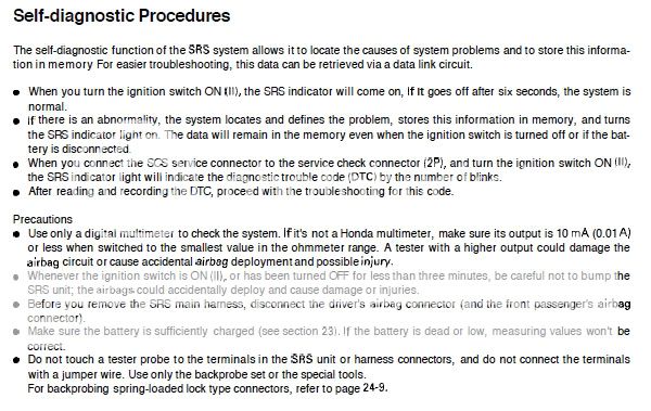

These diagrams are for 96-00 Civics (the SRS codes are for 96-97 Civics only), though the information likely also pertains to a 95 Civic (see also FAQs sticky):

Thank you Ron! Exactly what I was looking for.
