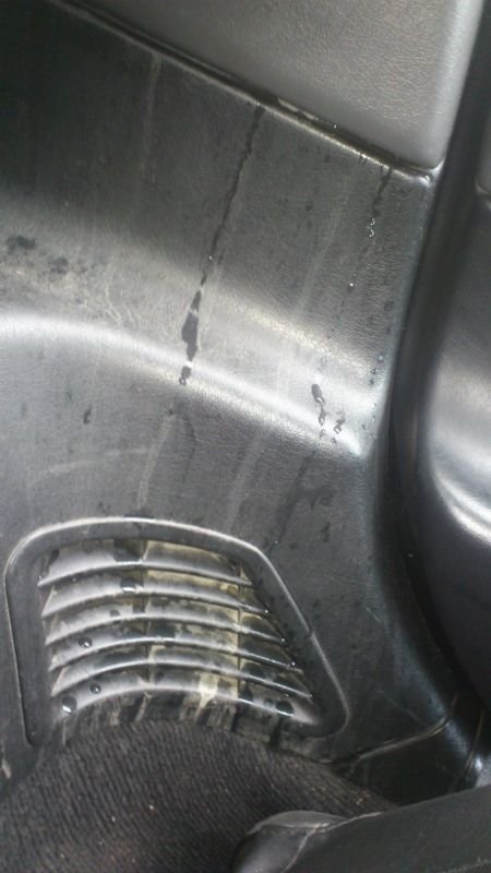

Hi
I got this nasty leak in the back from driver side.
I did the "washer trick" (bringing down the roof 3mm to get it tighter) hoping it will fix it but leak is still there.
So i think water is coming in from there.
All this area was wet even after few days of rain
(dont look the arrows)
Coming in from under this plastic
Running dow to speaker covers and all over the place
Passenger side is okay.
Any ideas how to fix it?

Re: 93 sol roof leak?
I had the same leak on my 93. I used some silicon spray but you should use grease on it let it sit, wiped it off then repeat a few times. It stopped leaking. It's been 6 months so far still dry.
Sol to Sol
Its actually probably coming in thru the front. That gasket was poorly designed, and they fixed it in 95 and up. It should shed water in front, instead it channels down the sides to the back, and then it gets inside.
Do like Jimi said, use low pressure air, and blow out the front and back weep holes. Should be able to see the lil hole in each one. Both front and back on each sides. .
If that doesn't fix it, try to puff em up with Honda Gasket treatment, not silicone. (apply several times,over several days, it will take a while to rejuvenate a 23 yr old car)
Then, if it still leaks... order the replacement gasket for the front, (all years are the same now), and undo the washer trick (it will wear out your new EXPENSIVE gasket prematurely) for a while and see if that does it..
If not, then try to find good used sides and back, or hope you can order them. (another current post with a member who was looking for them)
Majestic says they have them, so try here... Honda Automotive Parts
And good luck. We have unique cars with unique problems lol.
Thanks for your advice guys.
I will try the pressure air.
I used silicone spray few times, leaks in the corner of a-pillar are better now.
But place is leaking even when car is standing in front of my house and its raining
