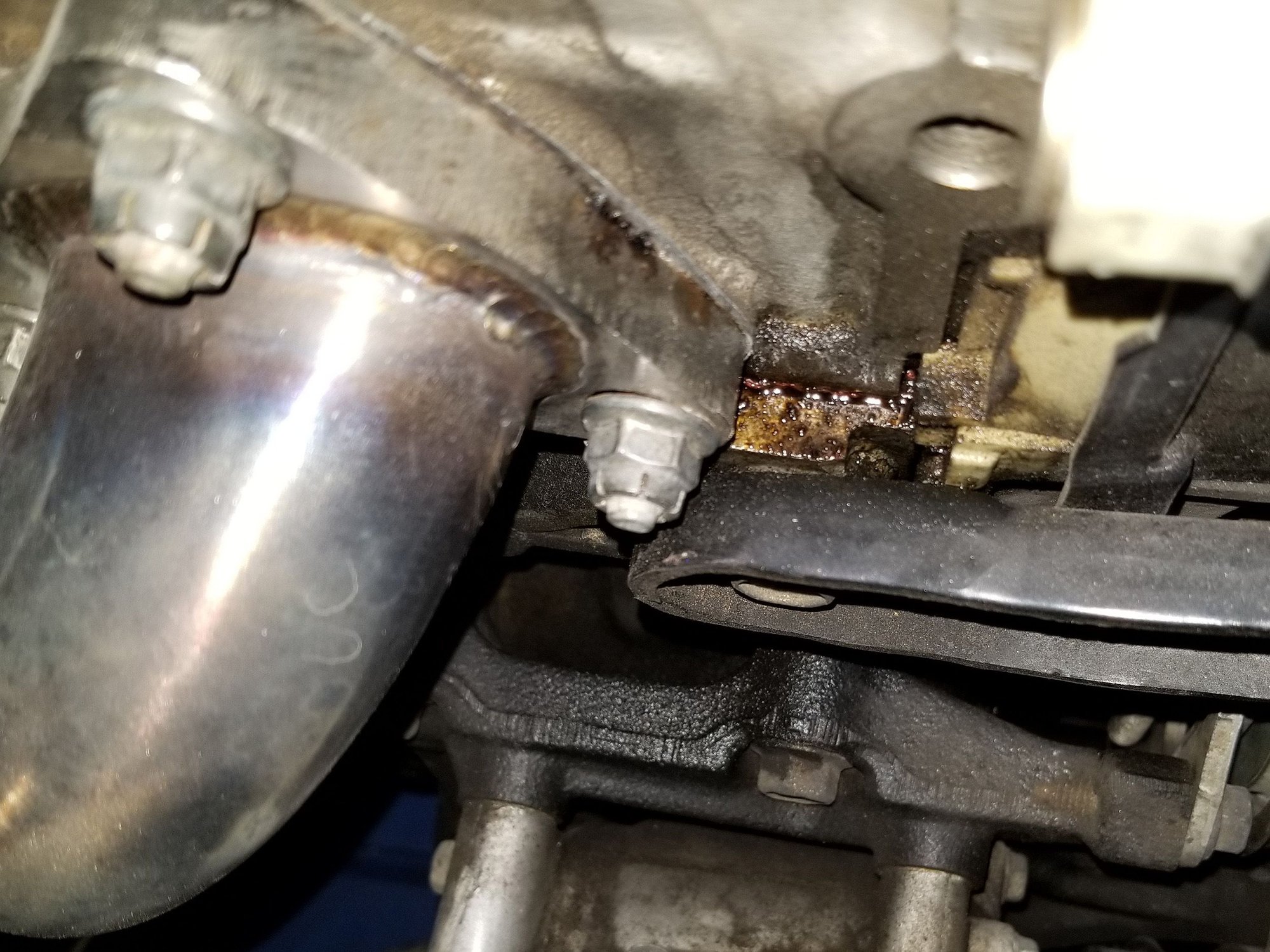

Alrighty then... Yesterday, I discovered that my engine started to leak oil. It's leaking from in between the head and the block, probably from the head gasket (refer to the photos). It must have developed within the last week or so because I know that this thing didn't leak oil the last time I checked, and the spots on the garage floor (which I didn't notice until yesterday) look quite fresh. What's worrying me is the amount of oil it's leaking. I think 5-10 drops of oil are leaking per hour (My class is an hour and I checked the spot I parked in and there was definitely more than one drop of fresh oil on the ground).I strongly disbelieve that the valve cover gasket is leaking because I replaced that myself like a pro, using Hondabond. The head gasket was replaced by the previous owner so I don't know how "correct" of a job he did. It seems he used red rtv on the head gasket though (visible in pic) and I've noticed some red chunks of rtv in my coolant reservoir; honestly, I don't know why that would be because there's no oil in the coolant and no coolant in the oil.
Anyways, what could be causing this sudden oil leak? It's a stock engine and I don't really beat on it too hard (hardly ever go to redline). Could this be a blow-by issue? Or is my head gasket about to crap out? What are your recommendations?

Heater stops working when a bubble of air / steam / combustion gas exists in the top of the engine instead of coolant. Either all the coolant leaked out or the head gasket leaks. The bubble leads to localized overheating and damage.
It would be unusual for oil to leak from that spot. There is no oil pressure there, only the return passage that lets the oil run out of the head back down to the oil pan. If you're leaking a steady drip of motor oil while running, check stuff on the back of the engine that handles oil under pressure-- the VTEC solenoid, oil pressure switch, and oil filter.

Those look like exhaust manifold bolts, if so, that's not the back side of the engine.
And it looks like plastic timing belt cover. Possibly the cam shaft seal blew out?
I remember one of my seals would spin freely in location so I used a little Honda bond on the outside rim of the new one to prevent that going forward. I know now that was overkill and it was likely an incorrectly sized after market seal or so old it shrunk enough to not pit the case correctly.

Before my last drive, I filled the coolant reservoir and I switched the air temp to cold. After the ~35 mile drive, the coolant level was exactly the same but I opened the radiator cap (once engine was cold) and again with the hiss of air/pressure escaping. The engine temp was normal and did not fluctuate during the drive.
As for the oil, yes that would be a weird place for it to leak since no oil is getting in the coolant (I think).

Yes this is the front of the engine next to the timing belt and I guess that could be the possible source of the oil leak. How do I find out for sure?
I will try to do a compression test as soon as possible.
