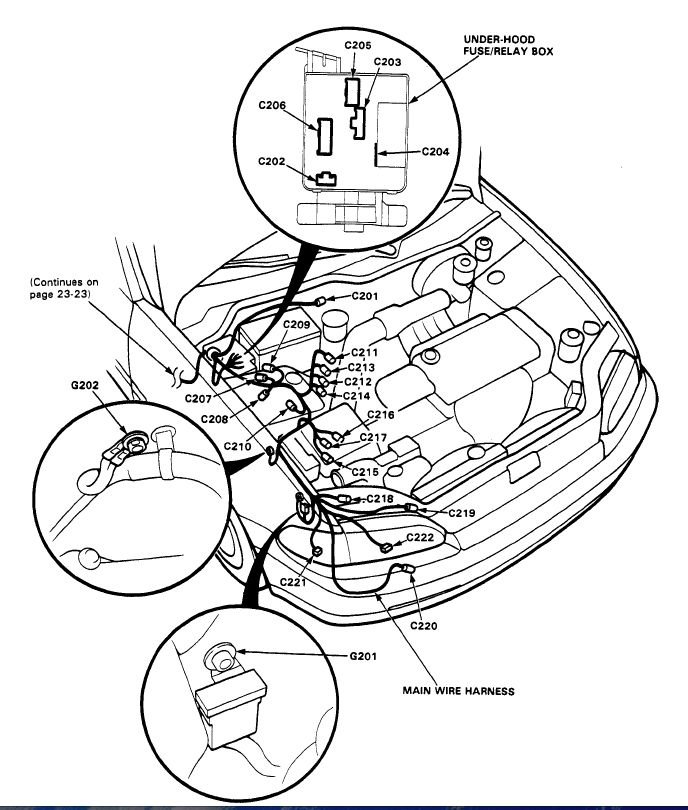

PM RonJ@HT for more info.
Old 05-04-2016, 05:50 PM
Former User's Avatar
Join Date: Feb 2008
Posts: 45,219
Received 44 Likes on 22 Posts
Default Re: 93 civic D16z6 red/blk cooling fan wire
The Blk wire grounds at G201:
Blk/Red not Red/Blk
It runs to the fan relay in the hood fuse box and gets voltage via fuse 33.
