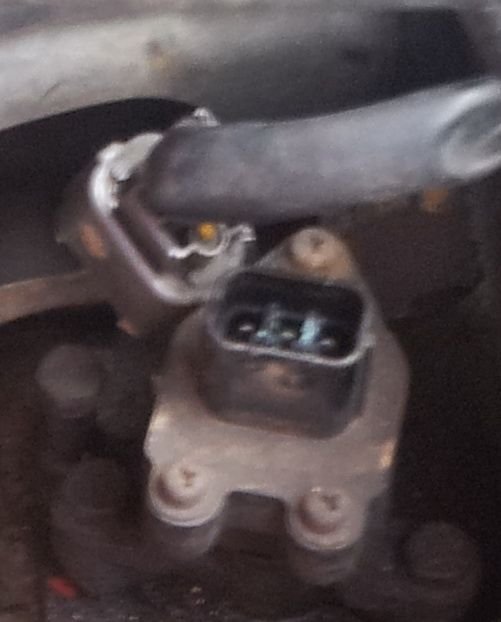

Thanks guys and Tony i just checked there ain't nothing where VSS is at. I have unplugged it just now to dry it up from moisture as it was still acting up. It was sporadically working.
I bought the grease and will seal up once it dries up pretty good. I can't tell if it's corroded but maybe i should use break cleaner inside the plug to clean it up?
I spy corrosion..

Default Re: 92 Civic VX - Odometer or VSS is not working after heavy rain
^The VSS terminals look corroded, though the zoomed picture is not focused.
Clean the corrosion from the VSS terminals, and depin the VSS wire harness connector. If necessary, cut the pins from the wire, resolder to clean wire, and then repin to the connector.
Thanks guys. I will take better focused pic soon but ron you lost me here.
Sorry i'm a noob here but what should i clean with what? Inside the vss plug or plug itself connected to bunch of wires. What should i clean it with?

I think i found an issue. When i was cleaning the inside of the plug little piece of metal came out. I think plug was corroded and snaped while i was cleaning it. Now it's done for good.
I placed an order for new plug $7 and new vss sensor $7 as well on ebay. For this much it's not worth messing around with. $14 and i will get this replaced. I will report once it's installed.

I have successfully replaced plug, i cut it and soldered in new plug to wires and since VSS was $7 and brand new (ebay) i have also replaced that as well. It works all well now. I believe issue was brittle (on the inside) worn out plug not vss but since both were so cheap I replaced both. VSS looked very good on the inside. No rust at all. Had few small pieces of metal shaving there. I have used dielectric grease to isolate and also i have used electrical tape everywhere twice wrapped. No chance of water getting there anymore. I forgot to grease inside vss and pin itself. Not sure if that's a big deal or not but it's done now. Thank you very much to everyone for great feedback.
