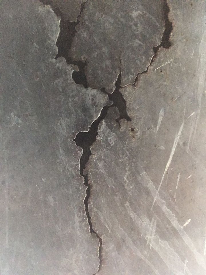

Also- just noticed a large crack in the bottom of the muffler that has rusted. Perhaps this could be a part of the problem?

Not likely, the scavenging back pressure is already created by the catalytic converter so an exhaust leak that far down in the system will not likely have that significant effect on how the car runs as much as it will have an effect on how the car sounds.
If the exhaust that far down had that significant of an effect the larger 2.5 inch and 3 inch cat back exhausts would cause significant running issues with the pass through fart cans, but they don't.
