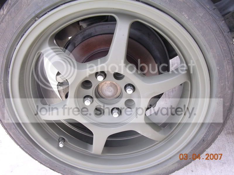

Ok, well I crashed My Integra (thats why i bought this thing)
And i put on the rear discs, and waiting for the motor Swap to put the fronts on all with SS lines.
