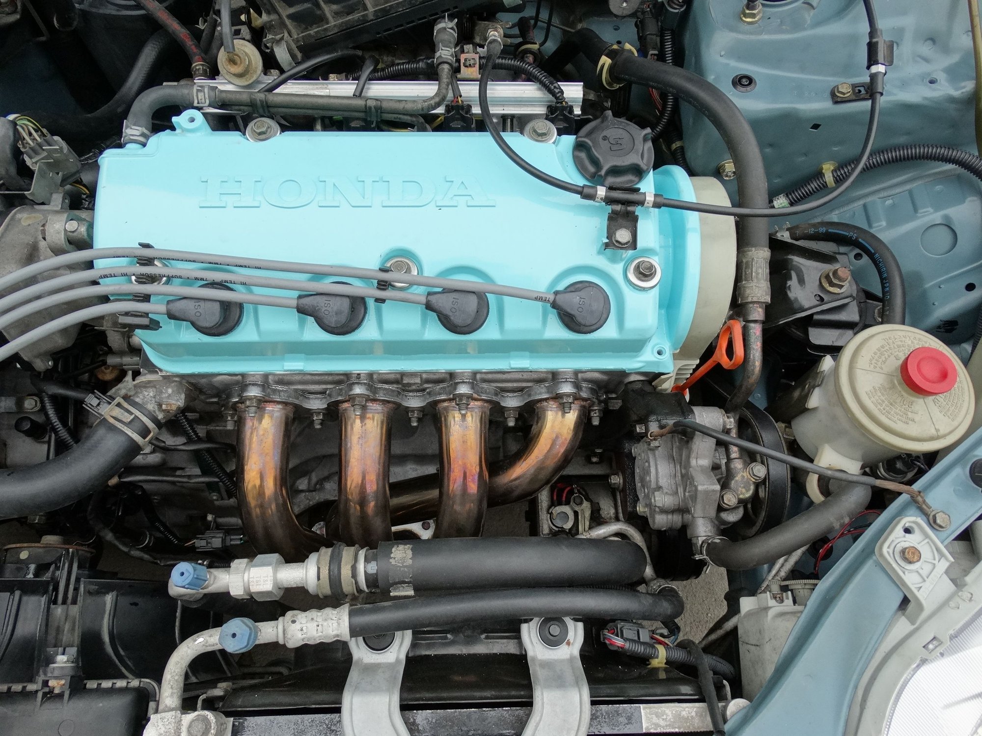

Thanks for all the help HT; here is the finished product purring like a kitten!
UPDATE(16SEP15): So, I am here to say I FINALLY have good news. The car is idling like a champ and the cooling fan problem I thought I had is no more. Thanks to everyone that gave their .02 cents. I am also posting up the pictures my wife and I took throughout this whole rebuild process.
UPDATE(13SEP15): Okay, just as a little progress report; the car is now running, but after 8mins, or so, the idle begins to surge.
Solution: Pulled IACV and TB. Cleaned IACV and corresponding mounting location on the TB. Then proceeded to do a on-the-road idle relearn. It wasn't by the book, per say, but it did the trick. I posted pictures of the IACV before I cleaned it on page 4, enjoy some nasty.
UPDATE(7SEP15): Bad coil, hopefully after I swap in a good one we'll get some life outta this motor!
Solution: New coil is in, along with new plug wires and the motor IS now running.

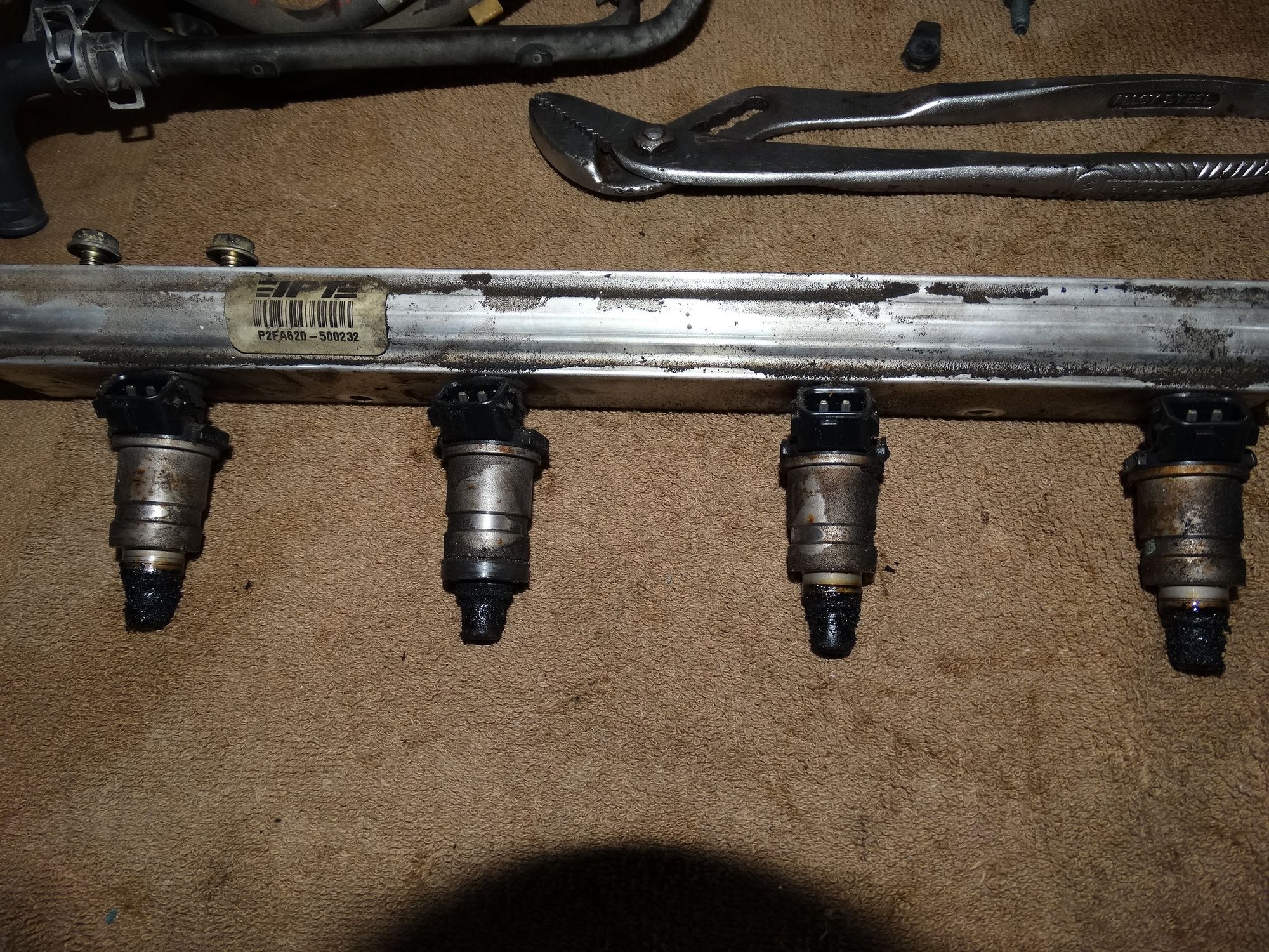

UPDATE(5SEP15): Injectors pulse when you crank motor, I have fuel pressure at the rail, it's getting spark, no CEL's, timing is dead on, plug wires ARE routed correctly, ...dizzy only goes on one way; I really am at a loss.

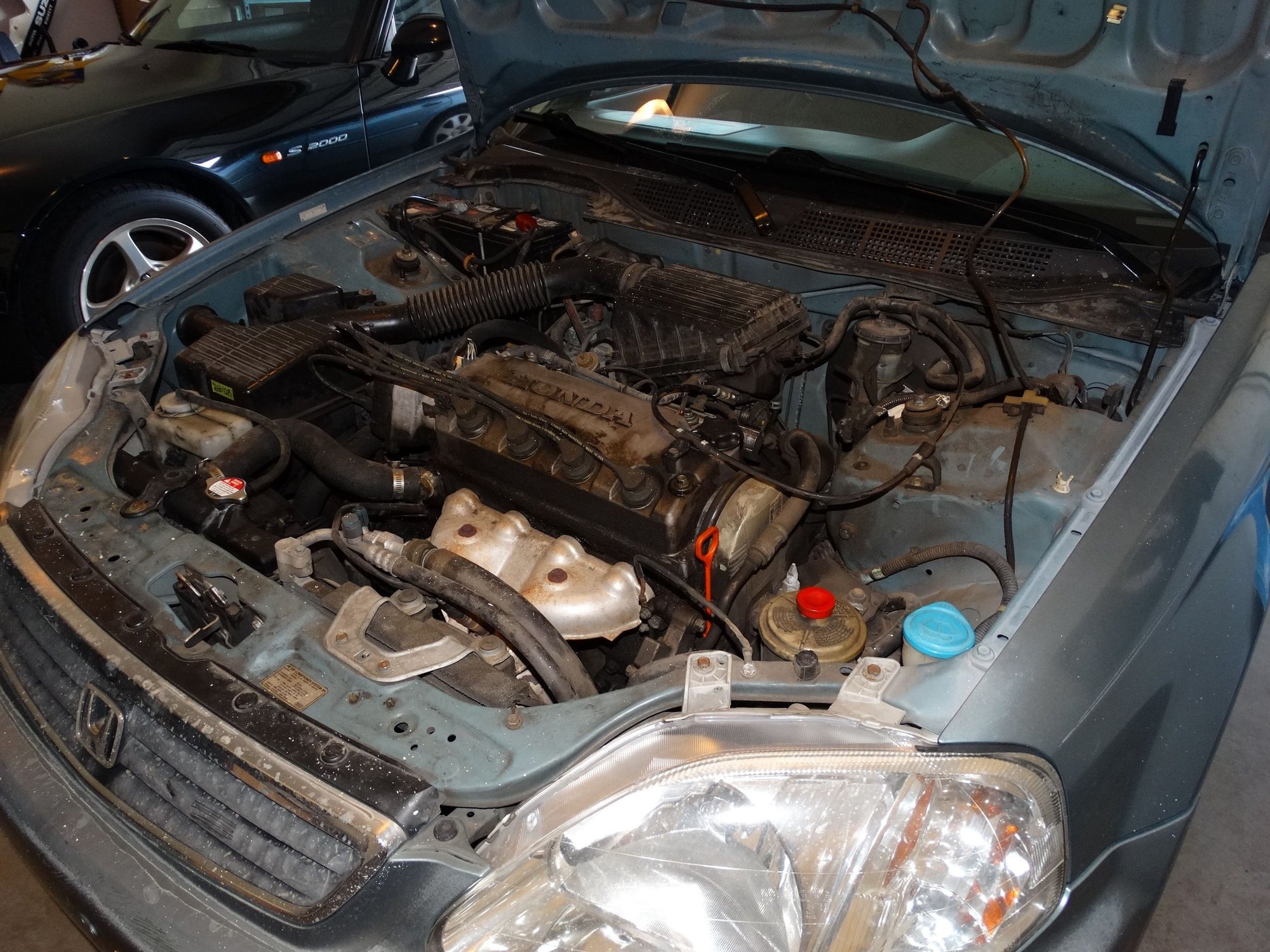

And here is what we started with about a month ago, when we took on this project.

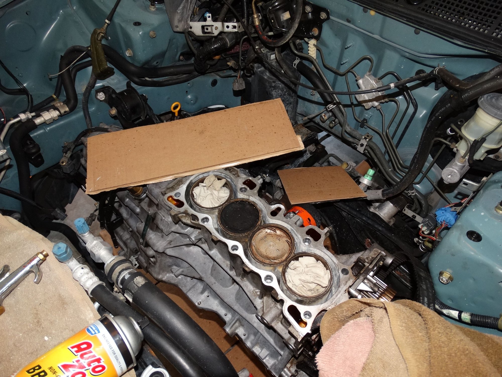

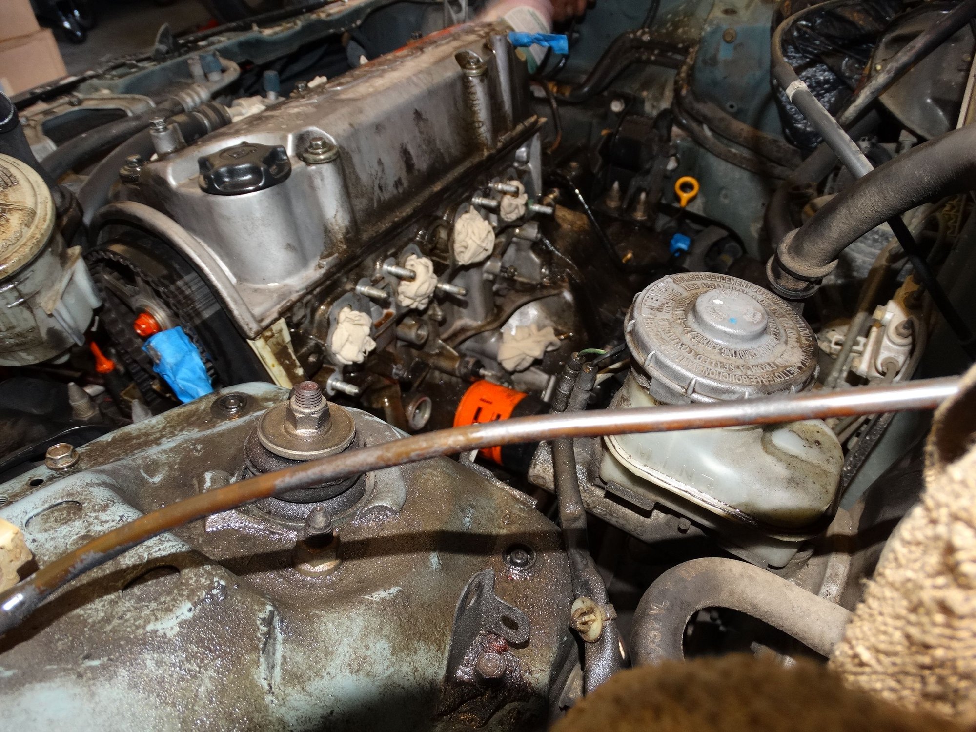

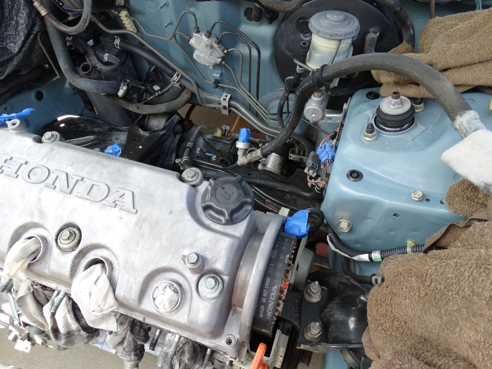

Not long after we started tearing everything down we began masking all open plugs, ports, ect for some full strength Purple Power! This stuff truly is amazing; I use it on damn near everything.

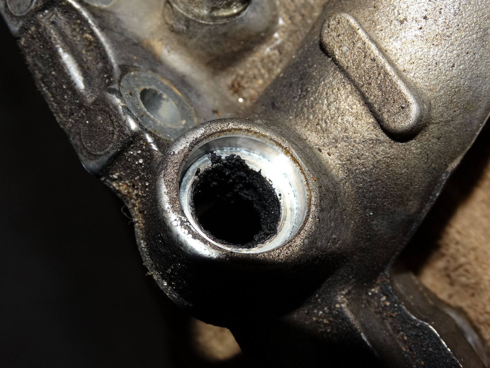

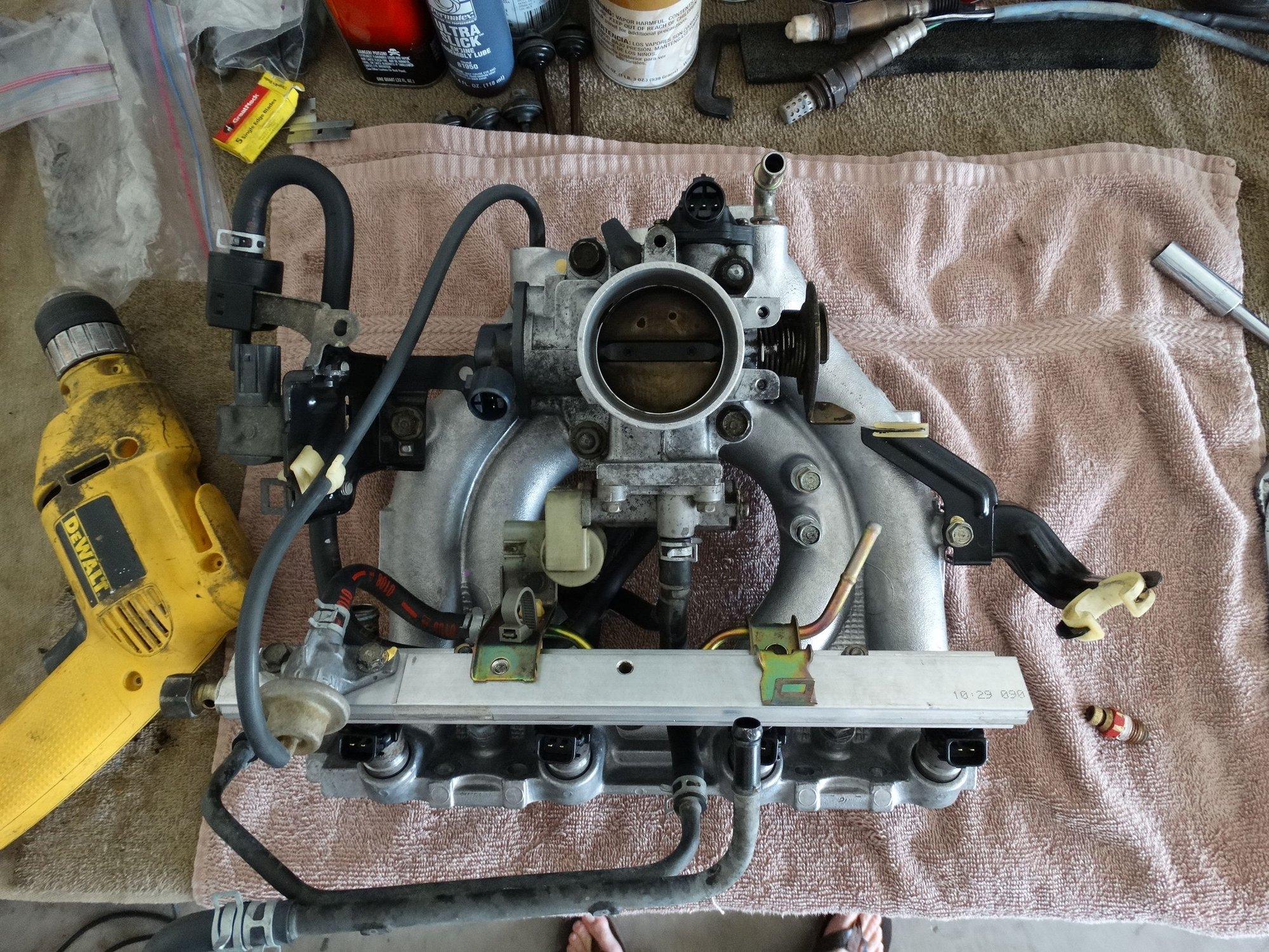

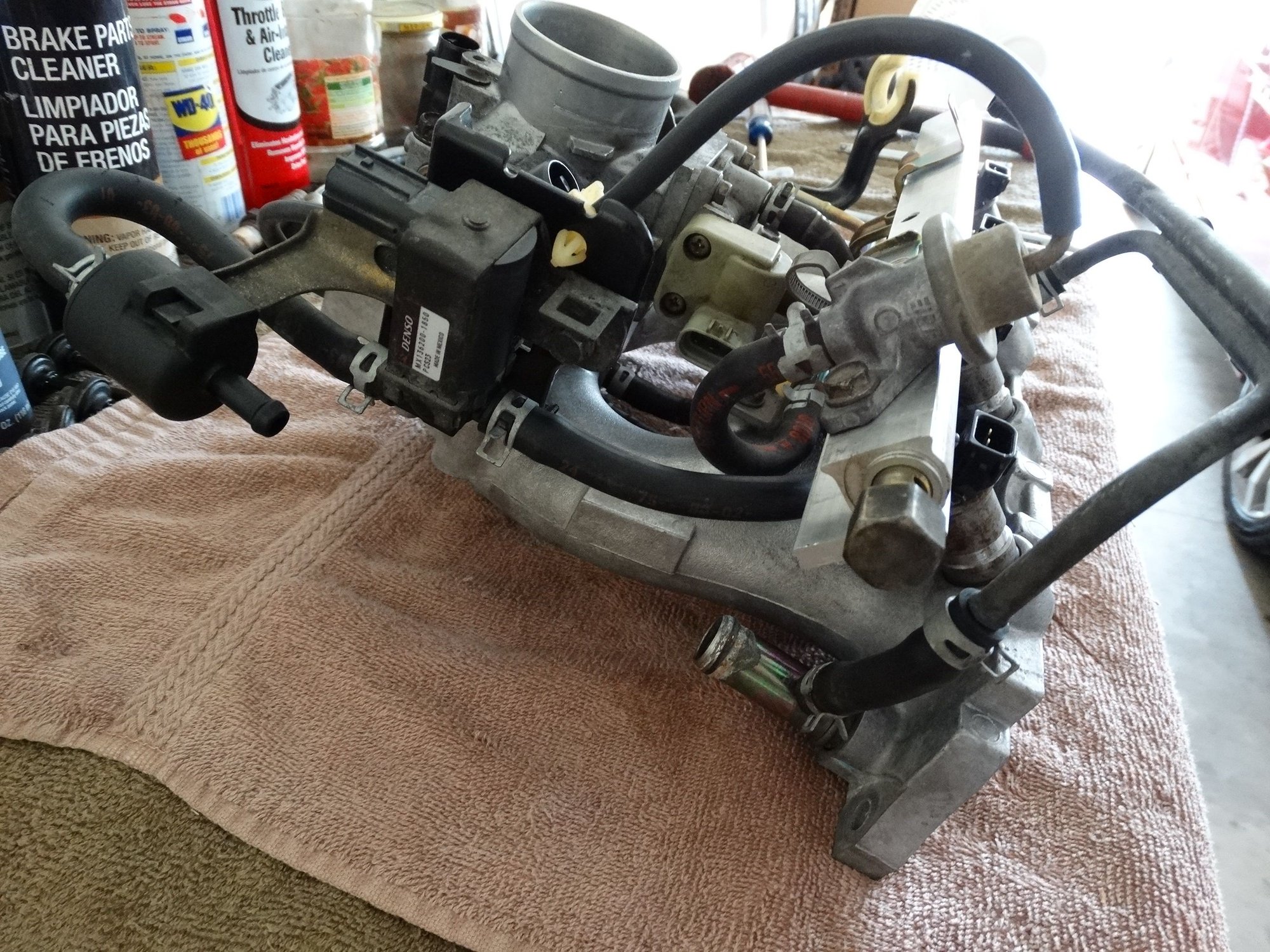

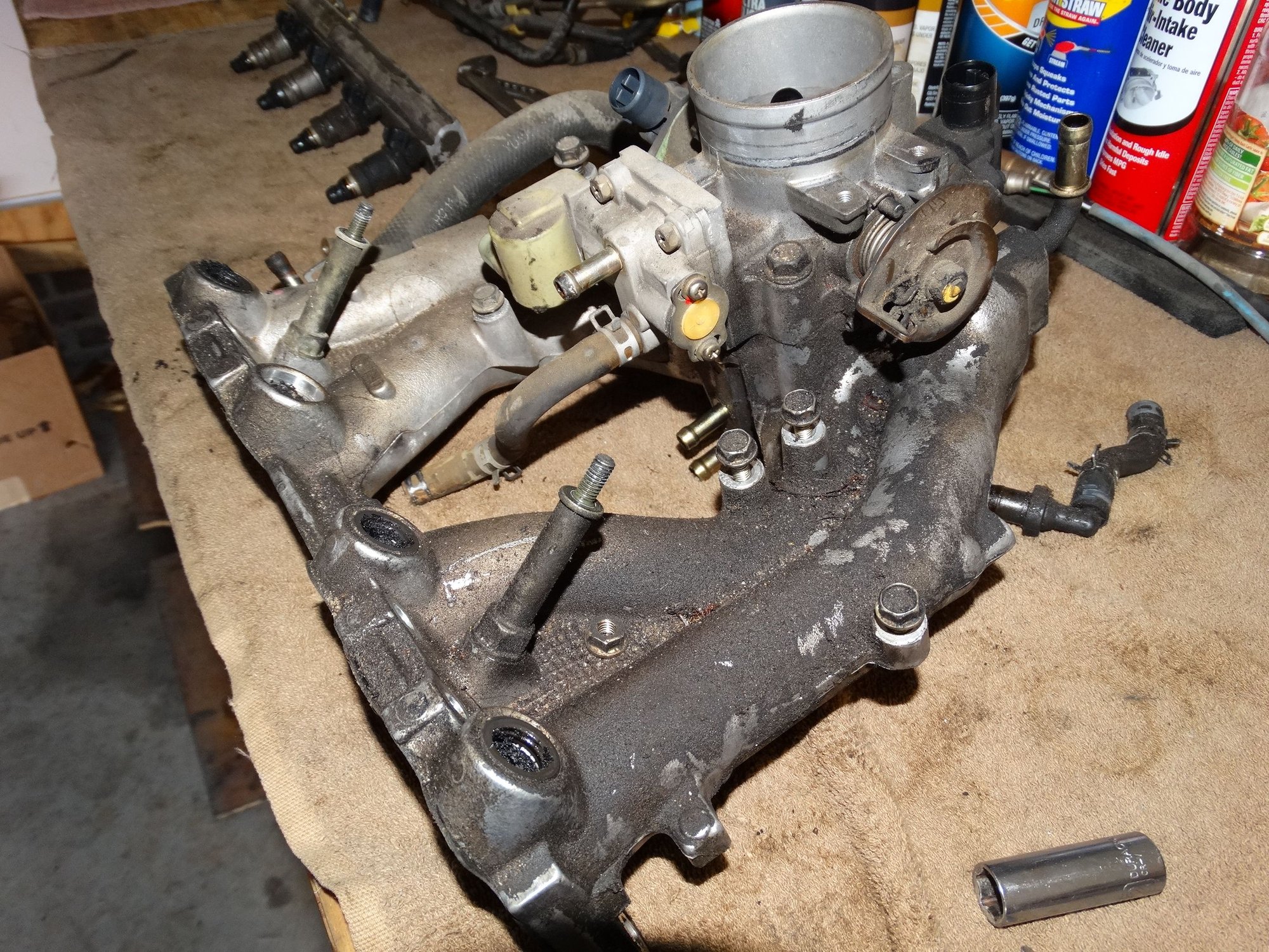

I then decided to tear apart the IM and TB assembly and clean it thoroughly.
I, unfortunately, got lazy and didn't take many pictures during final assembly. I didn't think it would be very interesting seeing me put every new hose and O-ring on.

That was my first plan of action Ron. I pulled the plastic intake components off and sprayed 2 shots of starting fluid into the TB and then cranked the motor over with no results; not even an attempt to start.
I then proceeded to pull the rail. I pulled the rail, cranked the engine and each injector sprayed as it should.
One step closer to finding the problem.
