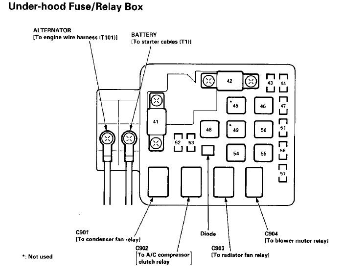

I downloaded the 2000 si service manual pdf and screenshot both fuse box diagrams. I dont see a 44 spot

You have the wrong fuse box diagrams.

Where's the 44 spot?

Engine bay, it states it in the image
