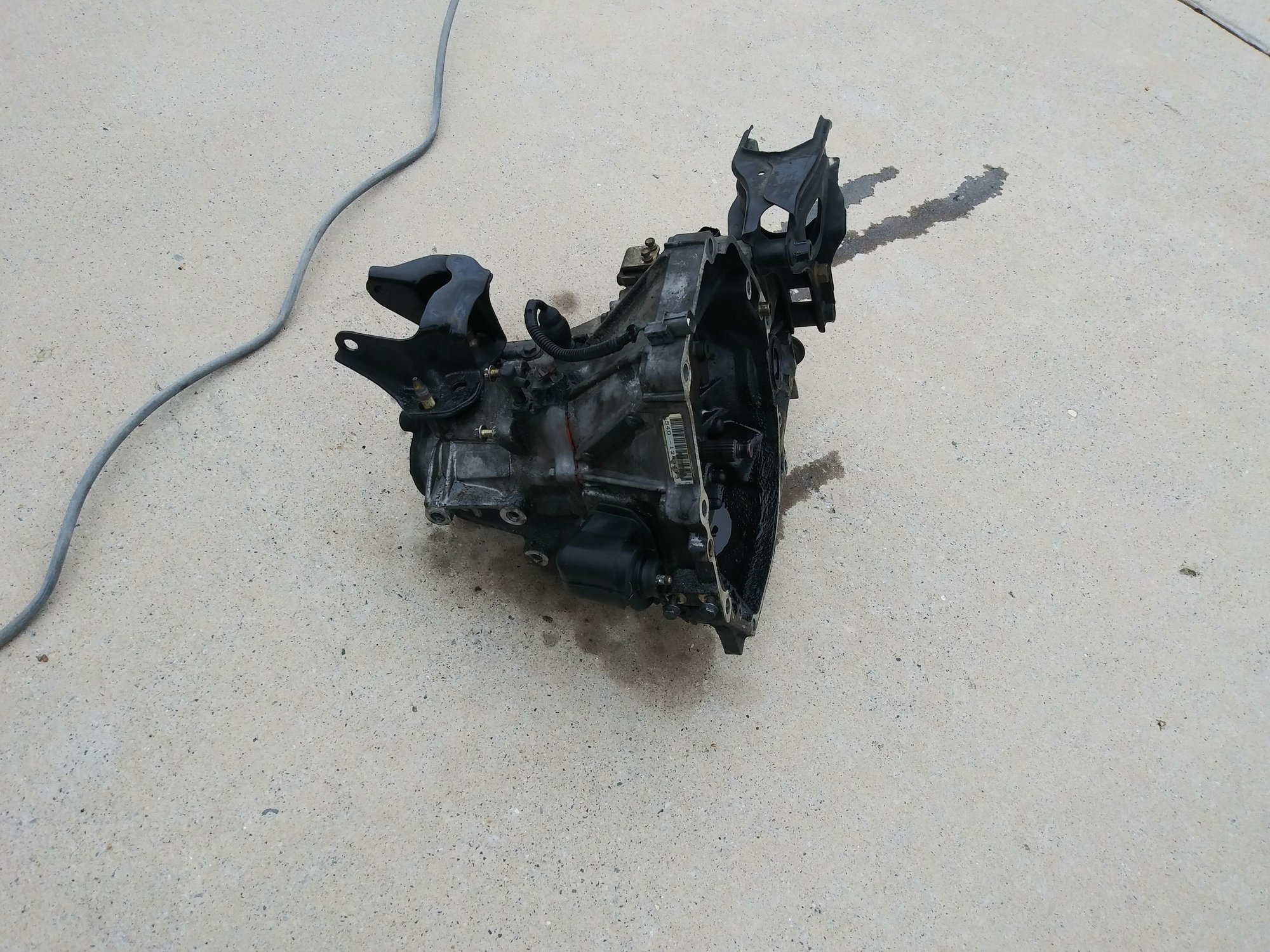

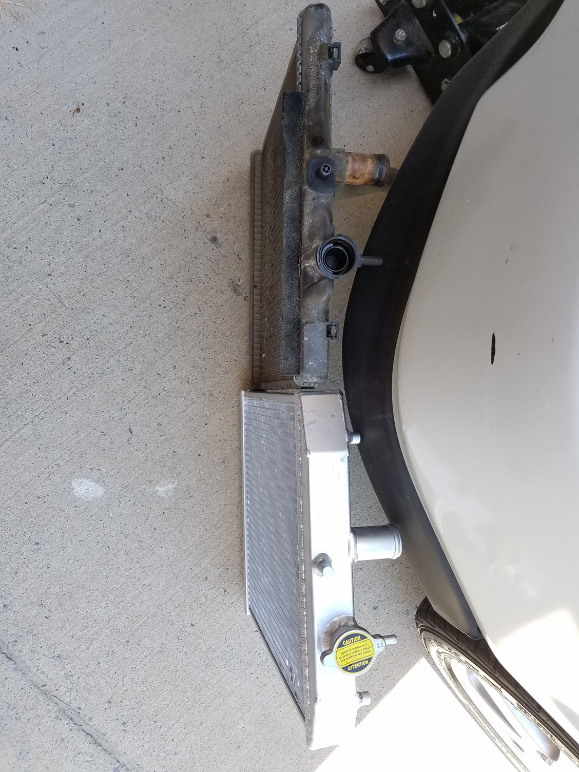

Getting the car home it was immediately evident there were a couple of oil leaks, either the rear main seal or the oil pan gasket. I had gotten lucky with a red hx the year before which turned out to only be the pan gasket so I went after that first. I also bought my maintenance list since I could tell this car had never been gone through.
The radiator was extremely light brown and worn, it was job #1 before ot went back into daily action. I also replace every hose with silicon hoses, its been my experience that a dseries will never blow a headgasket unless it has a coolant leak which are primarily caused by the rear coolant heater bypass hoses, usually the large u shape hose. I also polished the headlights with a power drill kit, I think it was the mother's headlight kit

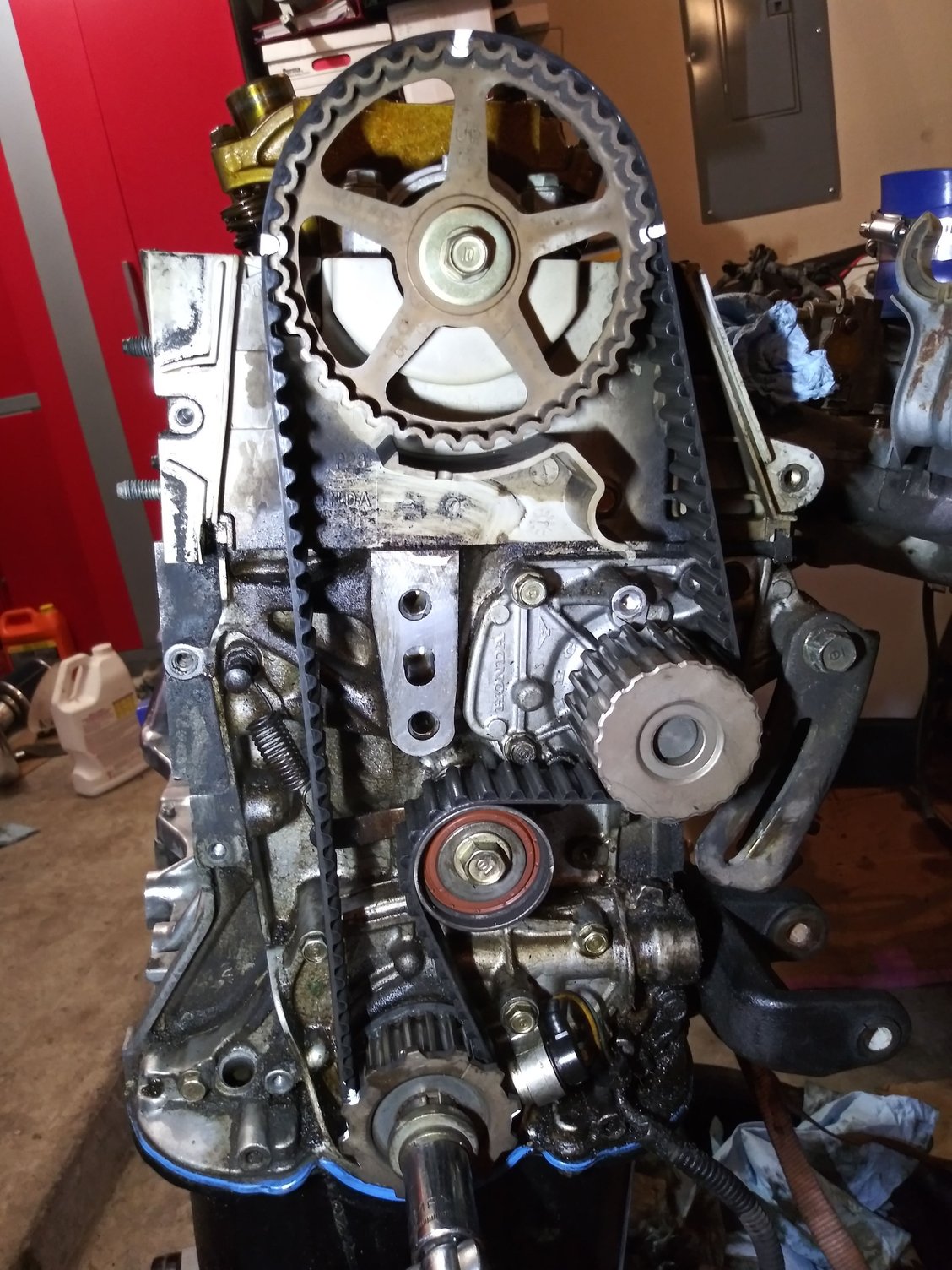

Originally Posted by eghatch9295
i like how thorough you are with your maintenance, but i don't understand why you use such cheap parts.
It's a gmb water pump and tensioner and continental belt. Honestly the d motors are so damn reliable that they don't need oem parts. All of my gaskets are felpro but other than that these are budget rebuilds. Im getting $2500 for a car after all my labor so the market determines what parts I use
The other 5 hondas ive done are still running trouble free

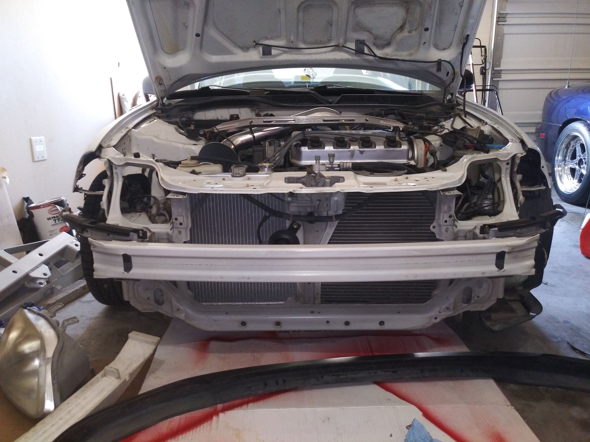

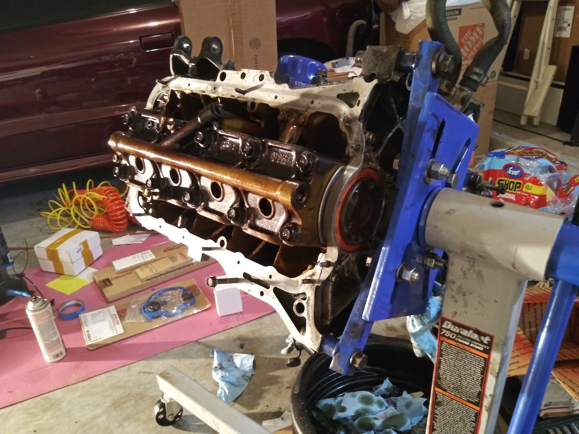

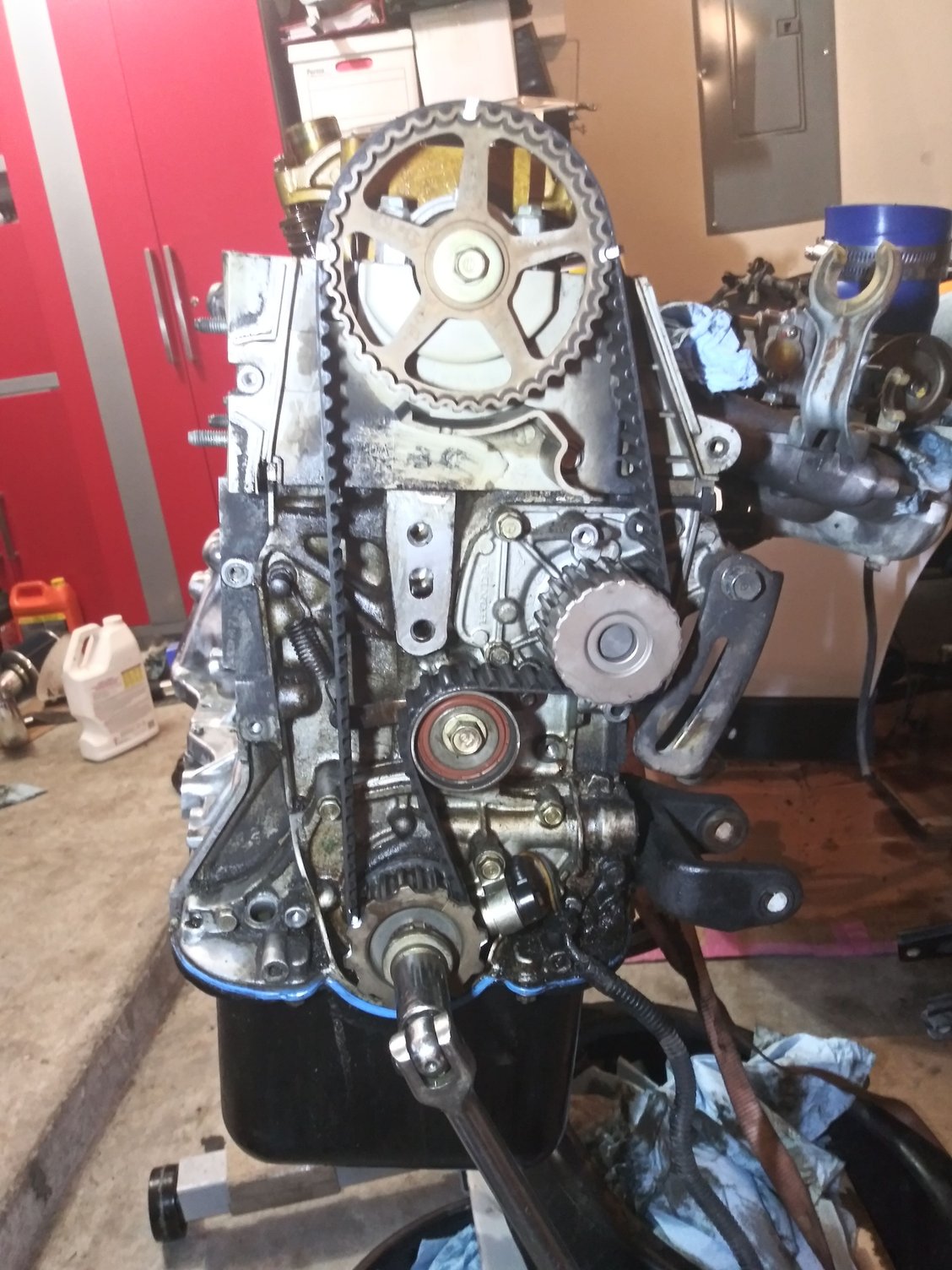

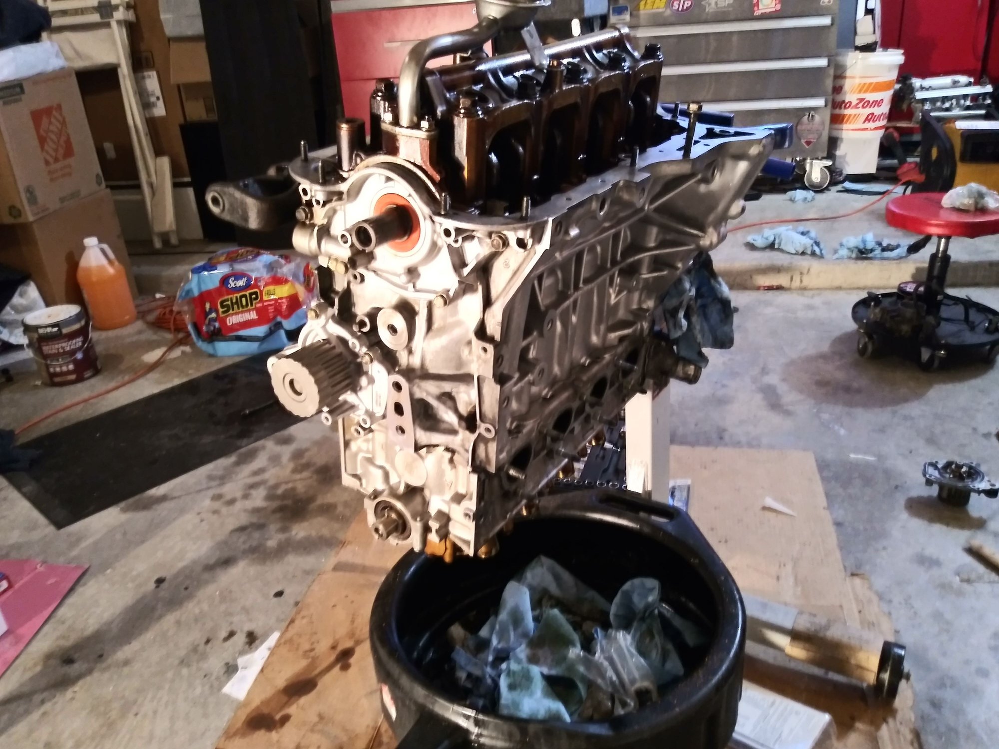

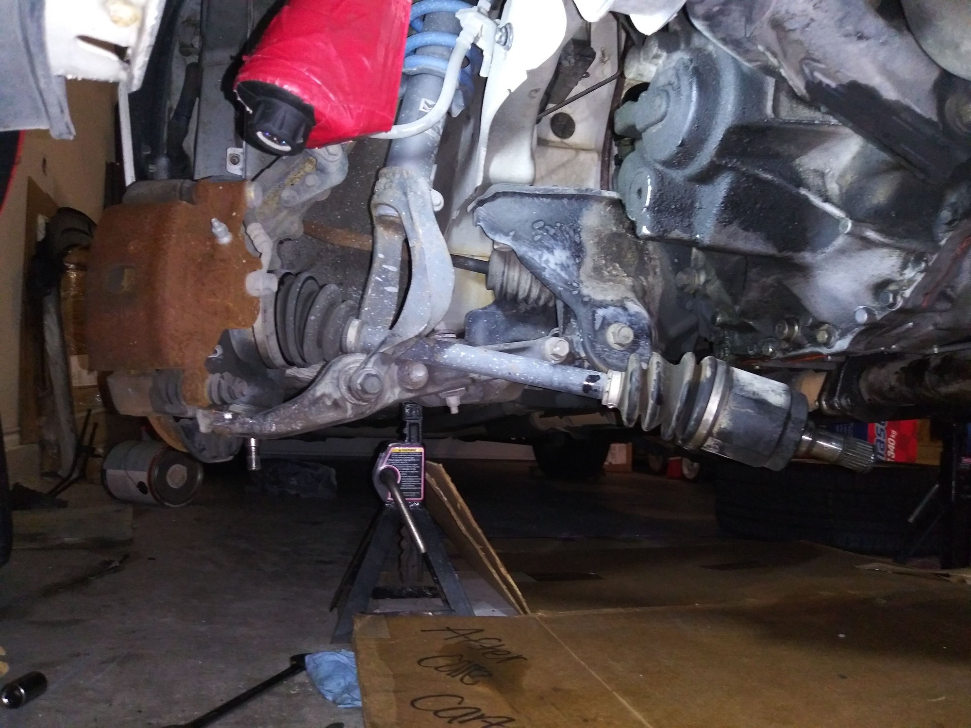

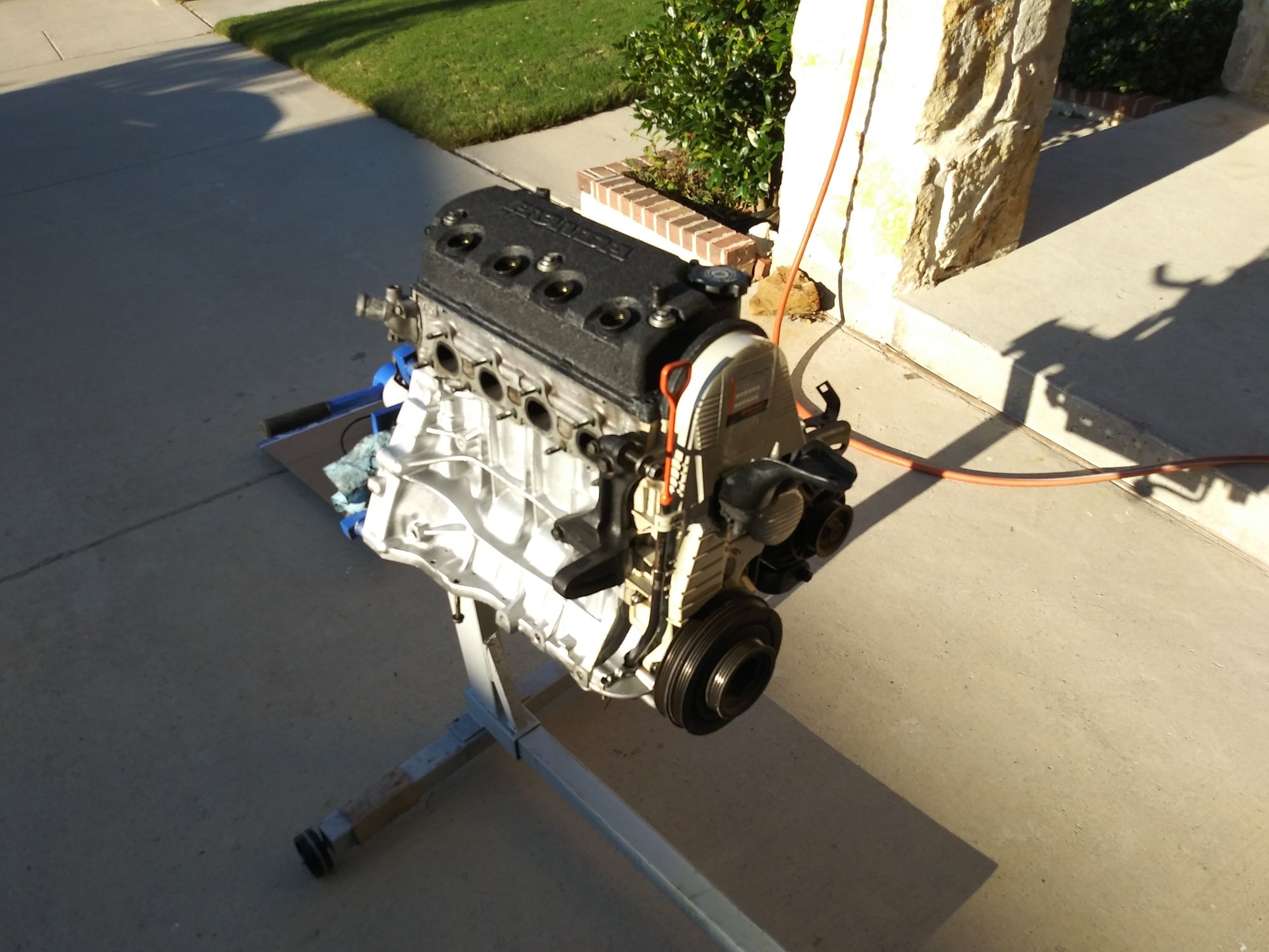

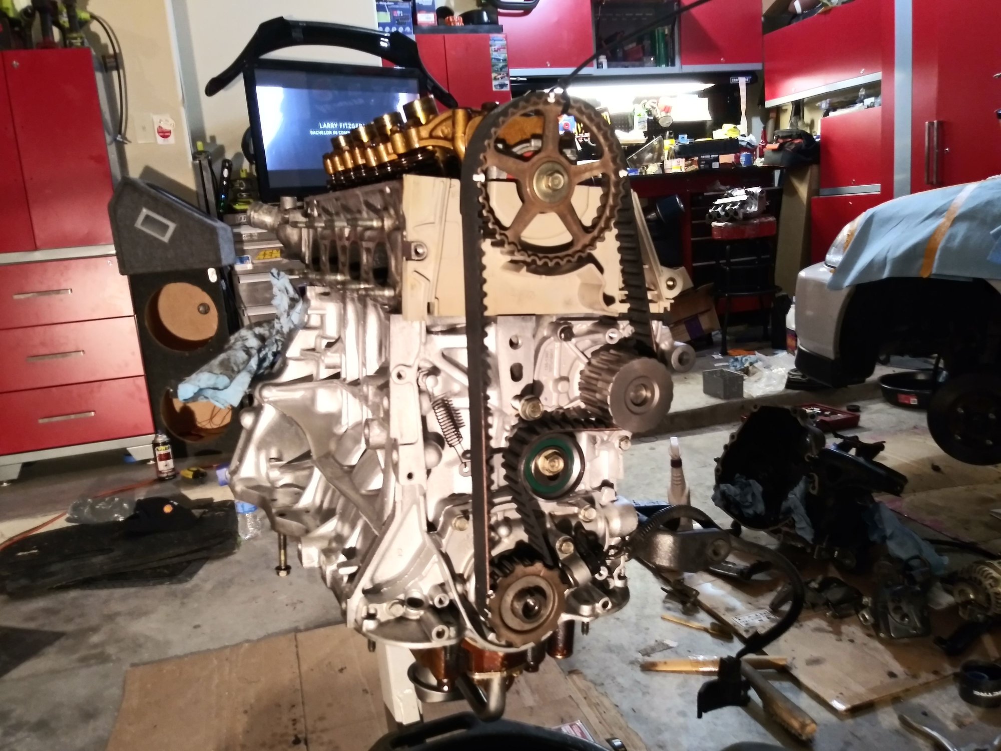

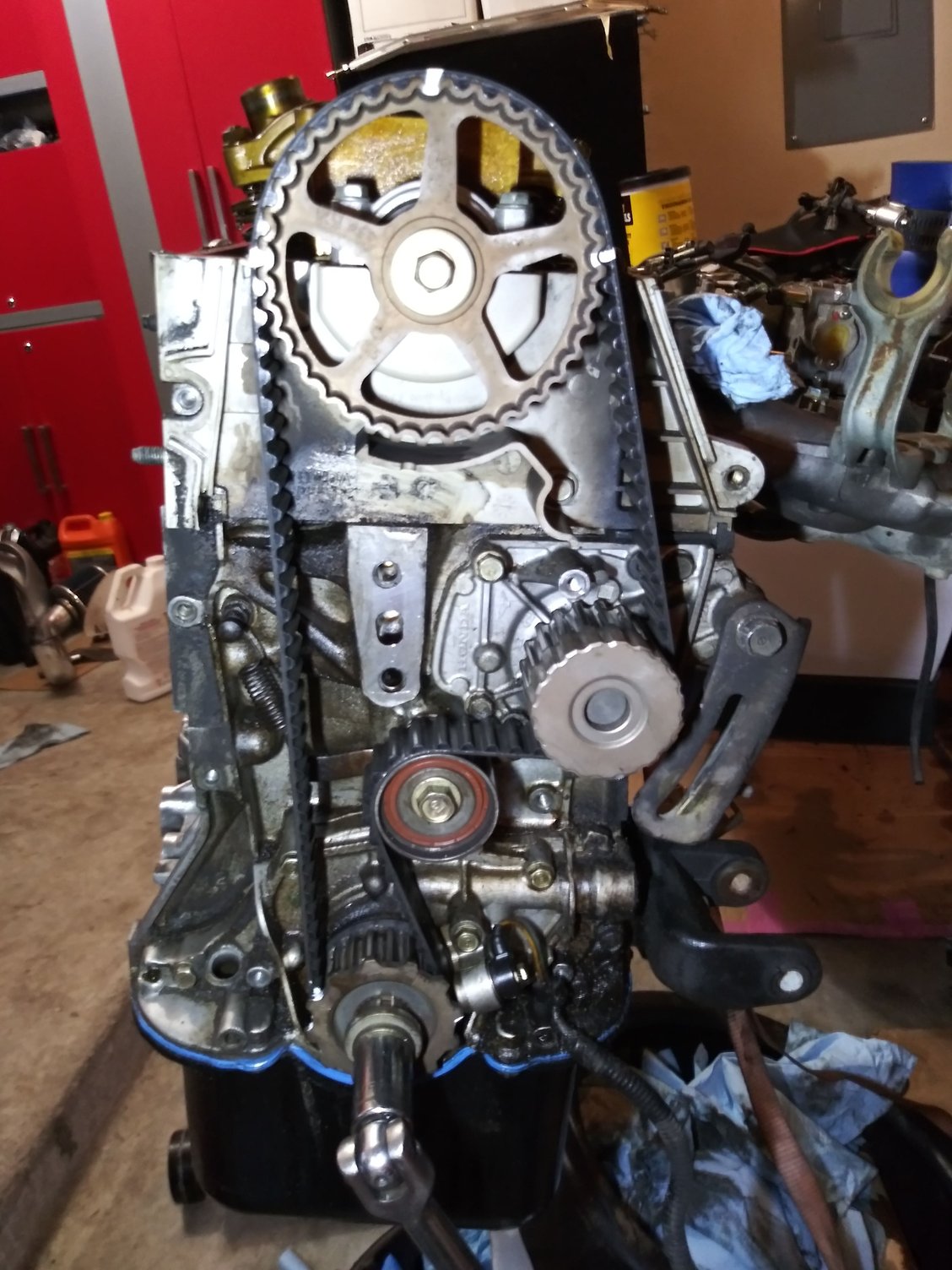

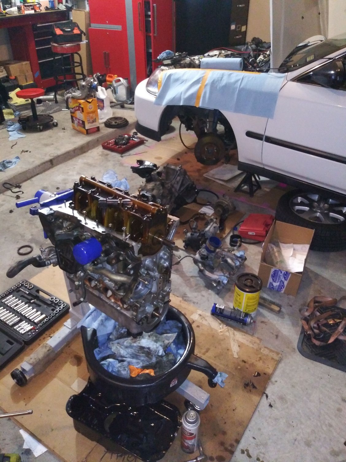

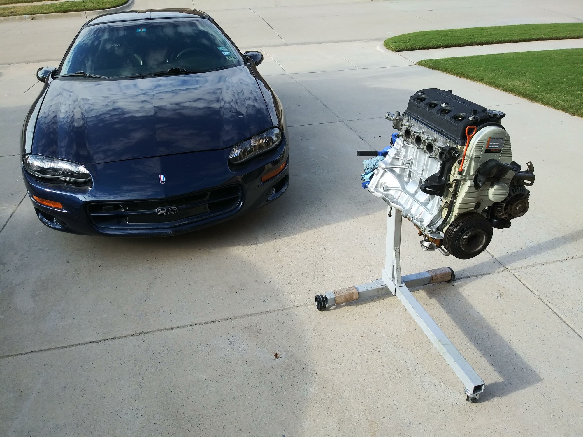

Ok so a little bit of context. I pulled the dash to put in the European dash with what I will call the central air vent. Its a big defroster looking vent in the middle of the dash. I've never had one before, but basically if you flip the lever in between the two center vents the big middle vent shoots thw air to about shoulder level between the two front seats to give your back seat passengers more heat or ac once youve gotten your chill or heater fill. It also has a ******* clock, because clocks are ******* awesome of course
I pulled the front bumper and headlights and wipe them down with shop wipes. I clean everything as I go including the radiator support and crash bars.
I then pulled the engine because it was leaking oil from everywhere. Most of the time its just a cam seal drip or rear main drip, but this car was leaking everywhere on each end of the motor. Only way to be sure I got every seal was to pull the motor. With an unknown service history its a good idea to just knock everything out now. So all 4 new motor mounts, gaskets, axle seals, everything that could leak or break, clutch etc
popped axles out to remove everything. Start from the bottom. I also remove the intake manifold first to disconnect the engine harness. Alot of swaps talk about dropping the harness with the motor, same difference time wise to remove the intake and unplug the harness from the top. I also replace the intake with the z6 intake manifold and reuse my y7 throttle body
engine harness unplugged and placed over the passengers fender
Dont ever use eBay oil pans! Never ever use anything but an oem honda oil pan!

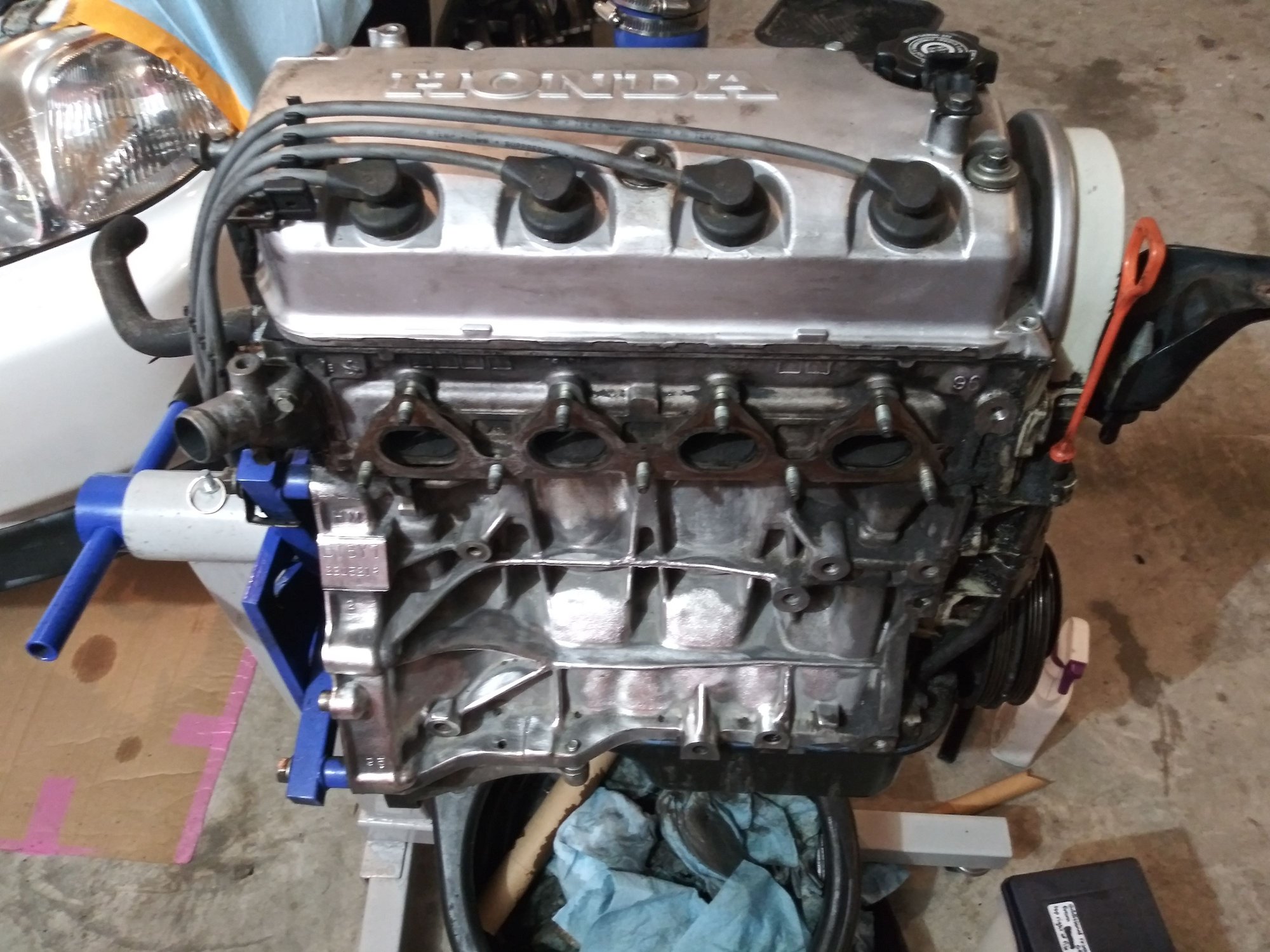

Before
Afterish

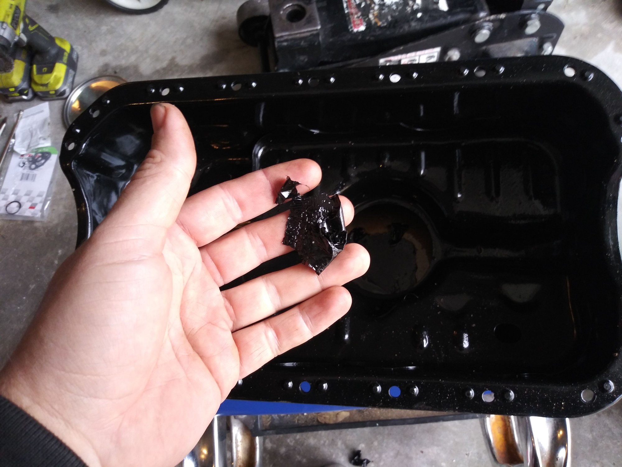

I thought you were gonna keep using the one that had paint flaking.

I left paint stripper in it for a few days now but it didn't get everything. I'd rather not risk the long term destruction of the engine from contamination for a $40 part

I truthfully have to say, oem oil pan does fine. I had to clean out the gunk in a b-series and all I used was diesel. no flaking.

My original pan had a big dent in it, and the eBay one was new and came with a new gasket. Lesson learned, I should have just been cheap and replaced only the gasket.
