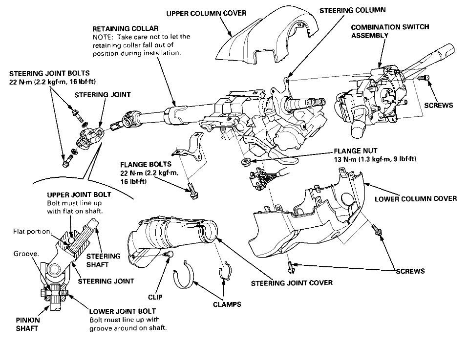

Not down low at the steering joint? Higher?
Remove the steering wheel and turn the wheels by hand to pinpoint.

so I had the front wheels off today to do an alignment. I was suspect that the creaking was coming from the kid who owned the car before me who curbed the front left wheel. I noticed with the front wheels off the ground that the steering wheel was harder to turn once it made its way to the left side. not sure why. I inspected the universal joint that goes through the firewall and it looked good. I cracked both of the bolts that hold it in place to ease up any potential tension that was on the column from the accident. no more creaking at the wheel. not sure if it is because of the alignment or what but it seems to be gone?? problem solved I guess

Creaking is back grrrr

Are there any issues with steering column bearings in these cars?
