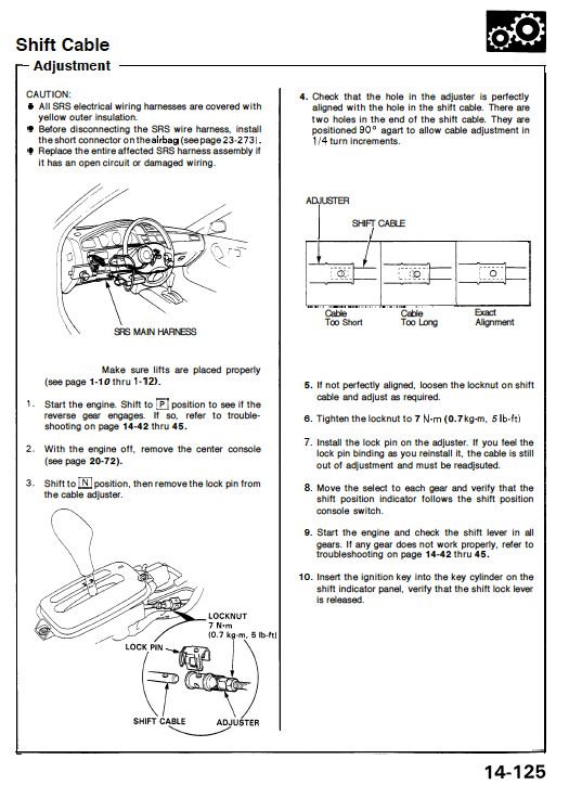

Old 10-20-2015, 02:20 PM

Old 10-20-2015, 04:12 PM

RonJ, which page is that? I was digging for it for OP, but couldn't find the damn thing.

Default Re: 1995 civic trans problem
People get annoyed that I don't post page numbers with diagrams. Here you go:

Tried the alignment and it was still dead on.. Like i said it stays in second.. If i select 2-d3-d4 still starts in second.. That cant be a shifter cable issue??
Also drained the trans again after looking and still was clean no shards nothing..
Still no check engine light and still no blinking d4
