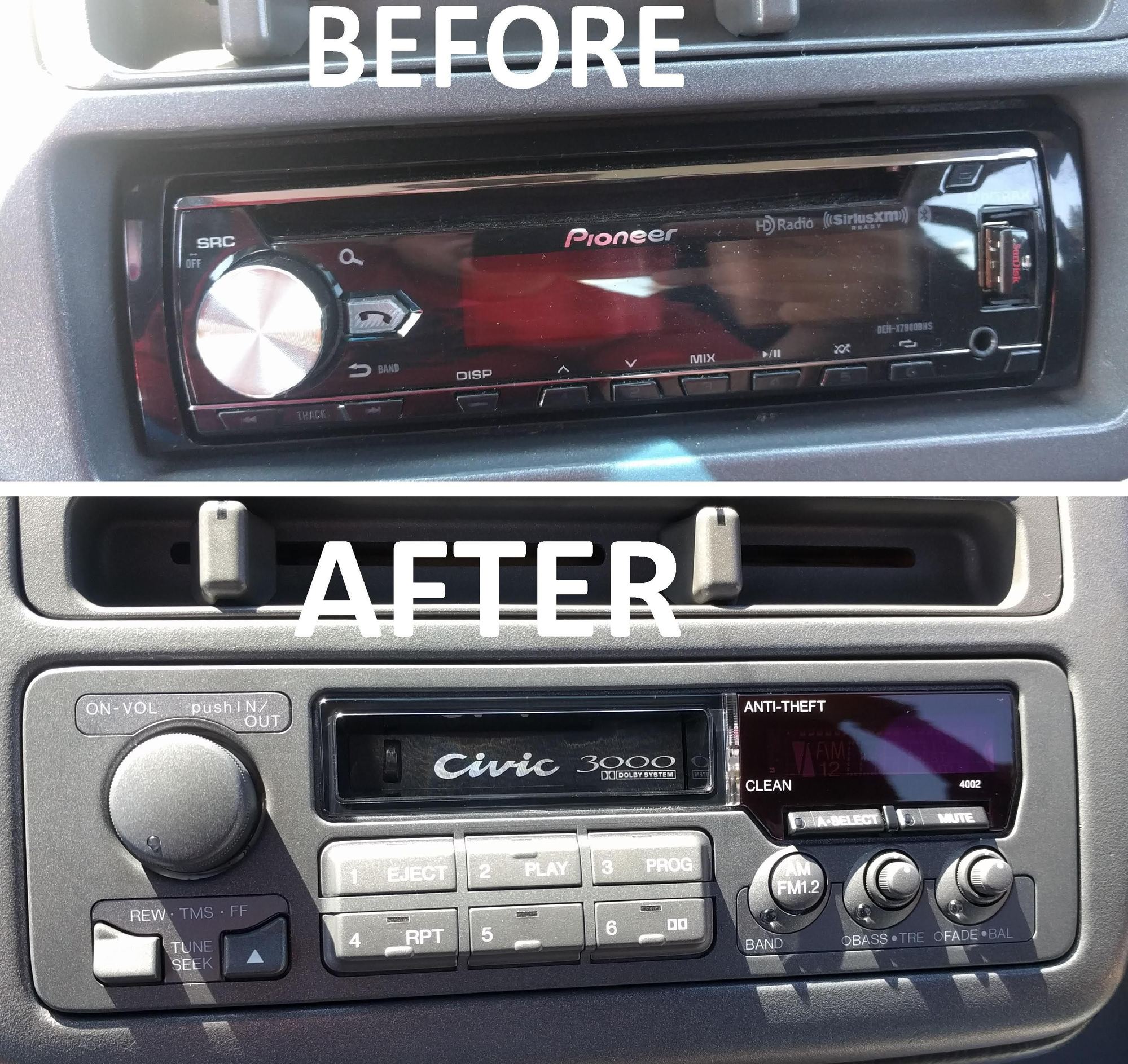

OEM Honda Civic stereo 3000 series (noise reduction, anti-theft, top upgrade for oem stereo honda accessories part #08A01-221-260
