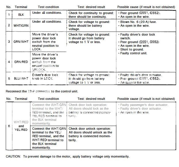

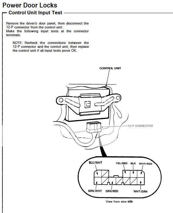

None of the power locks work? Do the doors manually lock and unlock easily? If so, double check 20A dash fuse 6 and then do the input tests shown in my next post.
i will give this a try and see how it goes! thanks.
