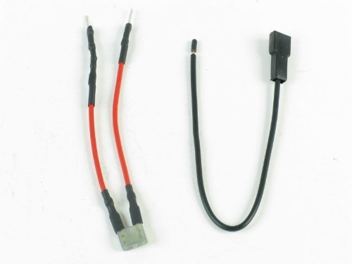

A good steering wheel boss allow you to keep your SRS cable reel. Typically they include an SRS-light cancelling resistor. I just installed an HKB OH-215 on my EG and that came with one. If your setup still has the cable reel behind the wheel-boss, but no resistor, you can buy the NRG resistor that is pre-wired. Simply slip it onto the two outside pins of your air-bag connector and the light goes out:
Amazon.com: NRG Steering Wheel Airbag Resistor Kit - Turns Off Airbag Light When Installing NRG Aftermarket Hub Adapter / Steering Wheel: Automotive Amazon.com: NRG Steering Wheel Airbag Resistor Kit - Turns Off Airbag Light When Installing NRG Aftermarket Hub Adapter / Steering Wheel: Automotive
If your boss required you to remove the cable reel, you can still use one of these resistors, but you are going to have to research which pins on the steering column plug should be jumped by said resistor.
Resistor is on the left (horn wire adapter is on the right):
Awesome, thanks a lot man.
