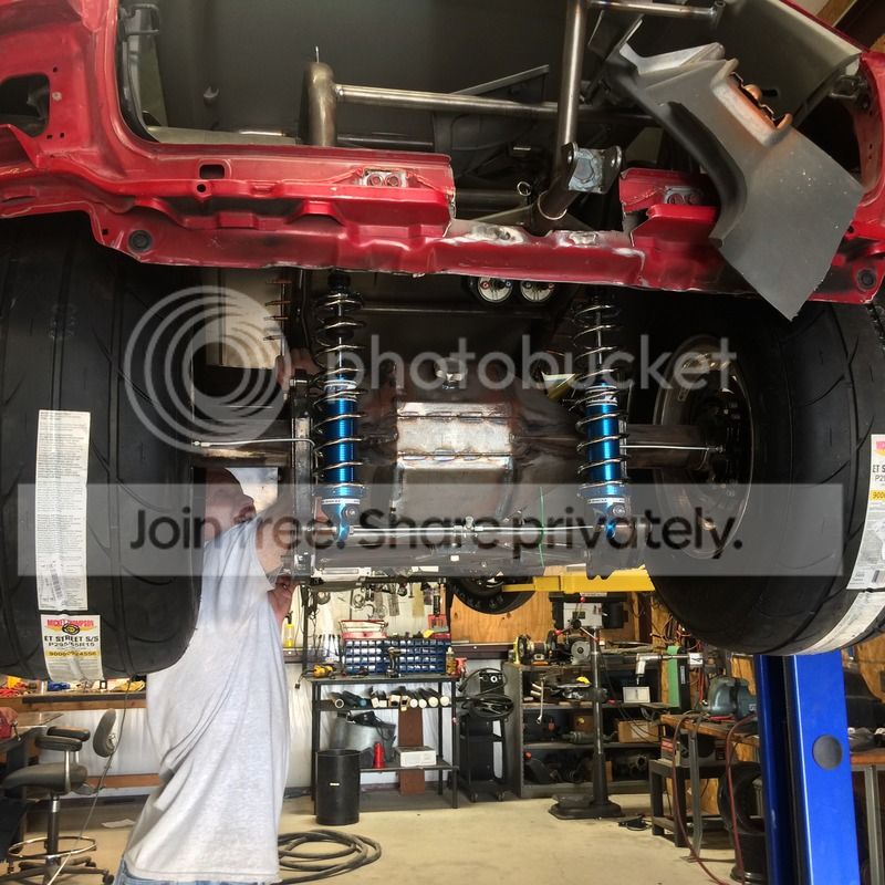

Painted it red then decided i didnt like the paint because it scratches to easy getting in and out of it. Now I will be using Duplicolor truck bed coating. Roll bar is the Kens Kustom Chassis Chromoly prebent 6pt. kit that I am thinkin about making it a 8pt with 2 more diagonal bars that connect main hoop and harness bar to the floor. Also want to add an X in the rear section.
Installing the rear diffuser and the mess afterwards:
Installing Bosch 044 fuel pump and lines
Started on my wire tucked. Took out all of the unnecessary wires that I wont need (engine harness plugs), Fuse box under the dash and battery will also be relocated:
Started installing Hasport motor mount on passenger side frame rail. Will be fully welded with no bolts for a clean look, still have some grinding and smoothing to do:
Removed the stock rear windows to put in the FAL Polymer windows:
Seats and harnesses that I took out of my other hatch before I sold it:
Front rad. support that person before me cut that i am rewelding to look cleaner:
Turned the fuel pump around and ran the power wire, still need to run the ground:
Picked up some sand paper from Harbor Freight to sand the red paint before I ley the truck bed coating down:
My easy way of doing it:

Posts: 820
How is the k-sport rideing for you? For some reason I cant adjust the k-sport to ride nicely, or either its too bouncey or too harsh.
Old 12-24-2007, 09:28 PM
phyzJunkieCivic's Avatar
Join Date: Sep 2005
Location: Dont You Just Love Lynn Cops, Boston MA, USMA
Posts: 820
It took long for my computer to load the images. Untill i saw the zip ties i was like wtf. As long the zip ties will hold up you be good, i rather use something stronger than zip ties, for your own saftey.

Default Re: (2tonecivic21)
My friends with omni power, tein, and tokico, say my hatch rode better than their cars. It handles like no other. Of course it is going to be a little stiff, i ride with it on the softest setting. Turn it to hard when I am drag racing. Don't know why yours rides so bouncy, maybe the shocks are blown?
Old 12-25-2007, 08:16 AM
HickamHatch's Avatar
Join Date: Aug 2005
Location: North Texas
Posts: 1,833
Default Re: (phyzJunkieCivic)
<TABLE WIDTH="90%" CELLSPACING=0 CELLPADDING=0 ALIGN=CENTER><TR><TD>Quote, originally posted by phyzJunkieCivic &raquo;</TD></TR><TR><TD CLASS="quote">It took long for my computer to load the images. Untill i saw the zip ties i was like wtf. As long the zip ties will hold up you be good, i rather use something stronger than zip ties, for your own saftey.</TD></TR></TABLE>
I dont think the zipties are going to break. I have so many on there. I took out the stock fuel lines and put the braided lines in their place. They aren't just dangling from the bottom of the chassis. They shouldn't go anywhere!
