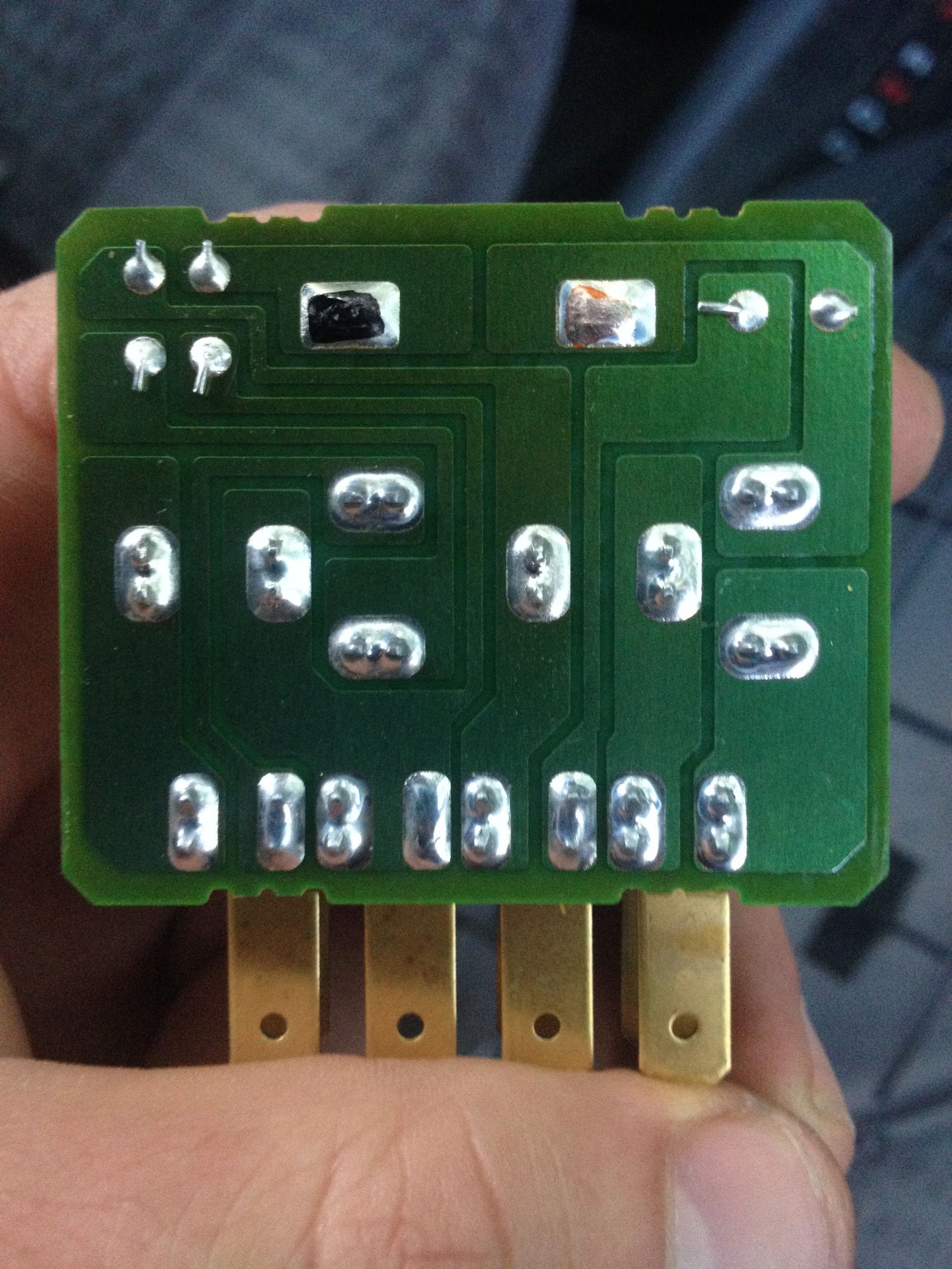

I would suggest touching up all the solder joints on the main relay just in case. Sometimes the solder joints can crack on the opposite side where you can't see them. Its a quick fix and worth a try. My 99 Si was intermittently stalling, and I dumped 300 bucks into a new ignition switch and distributor And found out later I had a faulty solder joint in my main relay. Took 20 minutes to fix including installation time. Also check the ignition switch too. There was a recall for that. I'm sure you've heard about it.

Its the ignition or main relay. More likely the main relay.
Ive seen it many times since 1998.

As I posted earlier, I can always hear the fuel pump priming, everytime. also the CEL goes on and off in 2 seconds.
I have attached a pic of the main relay, it is not very clear but there doesn't seem to be any solder defects in it. What would be the best way to test it? I am a student and I am limited on tools but I could get a hold of a multimeter.

I would still touch up all the solder joints because it can still be cracked on the side where it isn't visable. The cracks or damage aren't always as visable as you think. But my 99 Si was stalling intermittently, And everyone said it was the ignition switch or distrubutor. I touched up the joints on my main relay and never had the problem again. I would still touch it up if I were you. Now that I look at it there does seem to be a few hairline cracks but it's difficult to tell not having the actual relay in front of me. It would be smart to try since you have it out anyway. More times than not, the relay is the problem with this situation.

I mean if he already has it out why not try to repair it and save a couple bucks. Plus buying one means potentially waiting for one to come in the mail, or potentially dealing with the problem again in order to get to the auto parts store. But yeah you are right they're cheap as hell.

Yeah you are right, they are cheap. But I like the troubleshooting work so I am taking the relay with me to Lab tomorrow to retouch all the solders. I am still skeptic that it is the main relay as I hear the fuel pump prime even when the car doesn't start. But it is worth getting that issue out of the way!! Nailing down on the problem.
If the main relay turns out to be fine, I will go to the spark test. I will keep you updated!

If this^ is true when the engine won't start, then the main relay is a very unlikely culprit.
Test spark quality when the engine will not start. Could be a coil or ICM problem.

I checked the main relay using a power supply before i retouched the solders, and everything seemed to be working fine. But that is expected because the main relay was not hot.
I looked at the soldering and it also looked fine, with no hairline cracks.
I did retouch the solders though, and put it back in the car. I drove the car yesterday, and today and both days it restarted after i turned it off.
Fingers crossed that the soldering fixed it.
So yeah, it hasn't acted up yet so i can't check spark quality yet.

I had this same issue about a year ago in my EF. After replacing tons of **** (main relay being one of them) it turned out to be a bad coolant temp sensor. If you have 14 dollars give it a shot.
