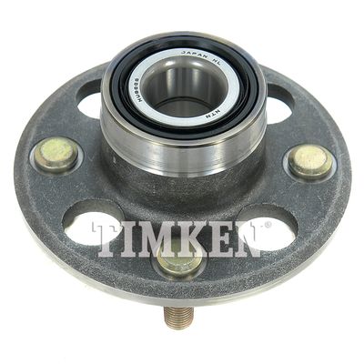

Okay, your OEM rear hub/bearing part number for your NON-ABS Coupe is 42200-S04-008 and sell for $105 shipped each at G1parts.com. The OEM bearing is made by NTN and can be purchased in an NTN box for a lot less if you search. ImportRP.com has them for $66 each (free shipping over $100): http://catalog.importrp.com/item.wws...N&weight=3.250
And no you cannot replace just the bearing. The outter race of the bearing is the hub.
The number on the hubs in google look like "HUB008", or just take your hub nut and washer off yours and read the part number of your originals. HUB008-72 cost only $39.79 each on Findiparts.com. You just need to confirm this part fits your car with a little google searching.

Thanks a ton. How'd you get the associated NTN part number? (The one leading to importrp.) Huge price difference there--that might save me quite a bit in the future. And I do only need outer tie rods, so the fact that they're the same regardless of power steering is great.

Well I searched google for "42200-S04-008 ntn" and found a close-up pic of the hub in the images section. Plus the last 3 digits of the OEM part number are 008, so I'm pretty sure that's the right bearing number. Again, if you take your hub-nut off the rear and pop the washer out, you'll see your OEM bearing number for yourself. This is how I would confirm.
Also, if you type both part number into google, you get several links that show both part numbers are interchangeable (some japanese parts list): http://infodozer.com/catalogs/ntn-wh...IO&maker=HONDA

The hub is the bearing. No worries about them being separate. You cannot pull the bearing out of a rear hub.
According to this NTN catalog, all the HUB008's are dimensionally identical. I'm not sure what the differences are for the different versions though because it doesn't show the inner race width in the NTN catalog (scroll to page 6): http://www.promshop.info/cataloguesh...heel-table.pdf

Did a little bit of leg work and found out that Timken makes the OEM hub/bearing assy, which uses the NTN bearing. The Timken part number is 513035 and they can be had for $40-50 after shipping on most auto parts websites.

It looks like you could be right. If you check out the Timken hub on the Autozone website, it does say NTN on the inner race. They must buy from NTN and put it in their box.

FYI: Then HUB008-72 is the right hub for you. Additional part number shown is 513035. Finditparts has cheap shipping ($6 for 2 hubs to NV) and a 15% off coupon you can use in the later stages of checkout "2ap311" that worked as of Monday. I don't think you can find a better price on NTN hubs.
http://www.finditparts.com/products/.../ntn-hub008-72
BTW: I don't think Timken actually makes anything. They just buy and repackage. Their front Integra wheel bearings are made by F.A.G. instead of NTN or Koyo.
***edit: Here's what I found about part numbers:
NTN Part numbers:
- HUB008-72 = 513035 = BR930033 = EF/EG/EK NON-ABS rear drum hub/bearing
