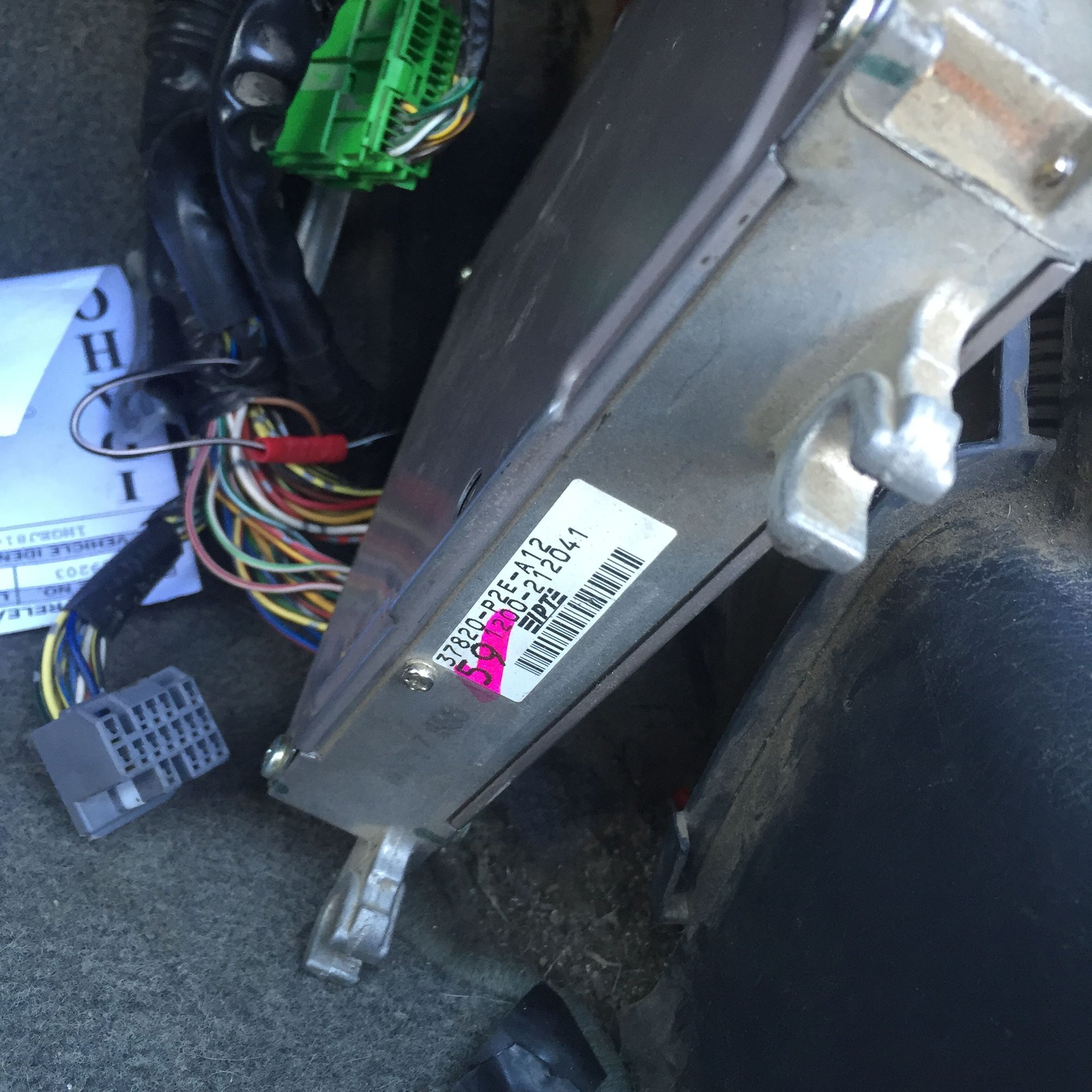

What ECU? P0138 suggests you are using a 96-98 Civic P2E ECU with a 99 Civic auto engine wire harness.
Old 04-06-2016, 02:55 PM
Loyalhondahaver's Avatar
Join Date: Nov 2011
Posts: 208
Default Re: 00 Civic Code 63 secondary o2
The
Believed to be a 99-00 d16y7 manual ECU.
Old 04-06-2016, 03:01 PM
Former User's Avatar
Join Date: Feb 2008
Posts: 45,219
Received 44 Likes on 22 Posts
My mistake.
