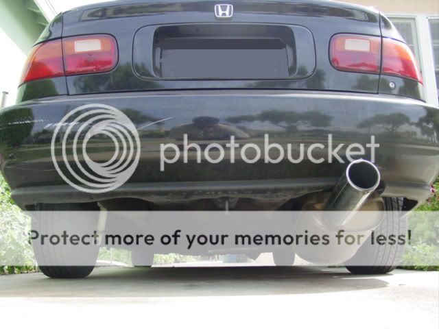

*Edit* I think i blew my engine (or something because it just wont run anymore) so i was never able to get my ticket cleared yet. So i dont really know what would happen when i go to court because i never got my front windshield signed off yet. So if anyone has been to court and passed this can you please add your comments to Page 3 and on? Thanks.
Now there has been some talk on here about getting a Exhaust ticket and not knowing what to do with it. Well i got one of these tickets and was like "finally i got the damn ticket now i could take the test." Now alot of you probably just go down to the court and just pay the ticket off. I say dont! You have no reason to pay whatever it is you have to pay to have your exhaust. Instead make it legal
First you have to have one of these:
Then you need to get one of these:
You dont need the defective windshield part just the first one. You need a 2175 violation (theres another one but i cant remember the number) off the top of my head.
Then you need to call 800.622.7733 and shedule an appointment to be able to take the test. (i couldnt take pics of the actual test being done because they wouldnt allow it, sorry)

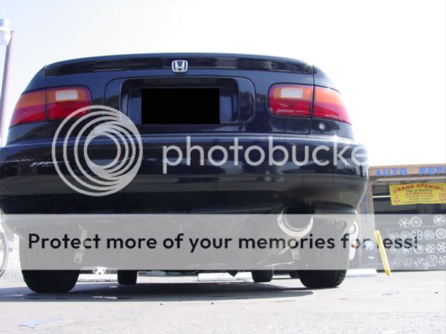

I went to take my test and i put my silencer on and done whatever i could do to keep my exhaust quiet. But to no avel it didnt help and i failed pretty damn bad. (i scored a 101db when the max is 95db (+/- 1.5))
Damn what am i going to do i thought. So i did what any normal human being would do, i put a stock one on that i got from a kid at school.
Now it looks like this:
You know you like that tilt
Then you go back to the state ref and take there test again.
With 2.25 pipping on a GSR motor with a STOCK muffler and cat. i scored a nice little number of 93db and pass
After you pass they give you this little sticker:
Now you have a sticker that says your exhaust is legal This sticker can not be removed and it is on your ticket so it has all your info on it so cops cant say **** about that its not yours. And it also has the same violation number that a cop would give you anyway.
Now some might be wondering what this test is. Basically what they do is take your car and rev it a little bit higher then 1/2 of your redline. I have a 94 GSR with a redline of 8200 so they reved it up to 4720rpm. While the car is reving they have there little noise tester saw how loud you are.
And that is how you could get your exhaust legal.
I went to the state ref thats in Monteray Park (ELACC (East LA Community College)). Now get your exhaust legal people and worry not about cops.
