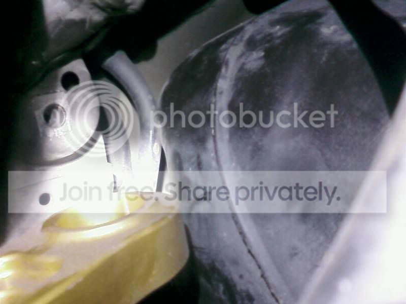

Well i got bored and decided to rotate my tires, tighten every thing up, even stiffen up my ride because because i was rubbing a little. go the to rear of the car and noticed something unusual.
i looked at the inside part of my camber kit and noticed this.
a rubber inside split in half and the pins were gone. same thing on the other side.
and the hole in the camber kit is pretty big and it wasnt even snug around the piece im holding in the first pic. with the wheel off i was able to shake my wheel back and forth.
so uhh....what now =(

i was clicking around skunk2's website but couldnt find an email address at the time. so i just sent a message to their myspace. a "ChrisL" replied to me with.
Please forward this to my email... ChrisL@Skunk2.com and I will get you out a new set.
awesome

hopefully they give me a revised set that fixes the issue. something along the lines of the SPC assembly which looks more reinforced. you should check yours too man, i've been hearing from other 8th owners that this is a common problem for bushing. i kinda saw this comming too. i mean what happens with rubber is in between 2 piece of steel..

so after a couple of weeks of unanswered emails, i took the time to drive out to Norco and pay Skunk2 a visit. i told them who i was explained my situation and also brought up the emails. Chris, who had just gotten out of a meeting told me that he never got any. miscommunication i guess.
anyway, after browsing though some cool magazines in the skunk2 lobby he came out with a hand full of bushings, 8 total. i swore they looked like the old ones but after i got them on, i havnt had a problem since. its probably a stronger polyurethane or something. about 6 out of 8 of my old bushings were either almost, or already torn. 2 on each side for the inner part of the arm. and 1 on each side where the bushing meets the brake assembly. didnt take long to put replace em but yea problem solved.

To the OP. I bought a skunk2 rear camber kit for my ef sedan. Held onto them for a year til I got my full suspension. Just recently installed everything. Did a rear disc swap and then my rear wheel bearing went out. I drove less then 100 miles on this kit by the way....anyways....I pulled the wheel off finally so I can pull the trailing arm off and get a new wheel bearing pressed. While I was doing that I noticed one of the bushings on the camber kit tore on the same side the wheel bearing went out. The side that attaches to the chassis but to the trailing arm itself on the camber arm.

the new bushings are more "wet" than the old bushings.

this is why people are recommending the spc rear arms over skunk2; the bushings are supposed to last longer on spc. hopefully the newer bushings last longer than the old ones.
