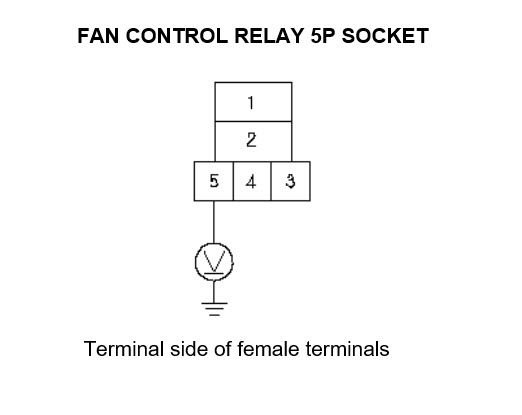

There are 4 separate relays that are part of the cooling fan circuits. You'll need a multi-meter to do some tests.
Here is one test:
Remove the fan control relay (#4 in diagram) from the under-hood fuse/relay box.
Set the multi-meter to check for voltage.
Turn the ignition switch to the ON position. (Car not started or running.)
Touch the multi-meter red lead to terminal no. 5 of the fan relay control socket in the under-hood fuse/relay box. Multi-meter black lead touching body ground (bar metal on car chassis, ground bolt, etc.).
Is there battery voltage? Standard battery voltage is 12 volts.
If there is no voltage and under-dash Fuse No. 36 (10A) is good, then there is an open (break) in the circuit between those two points.
