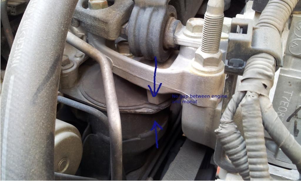

take a look at your passenger side mount. If the gap its to closed, that could be source of the vibration. You will have to replace the engine mount.

So this was what i initially thought, but i had just replaced the thing less than a year ago. SURELY THE PART COULDN'T HAVE FAILED THAT QUICKLY, MUST NOT NEED TO CHECK IT.
fastforward to me standing outside with the mechanic.
Me: "It sounds and feels like a motor mount but--"
Him: "It's the motor mount"
Me: "But i just replaced it last year,"
Him: "Ya but it's the motor mount."
Me: "Impossible!"
Him: *shifts through gears*
Me: "So it's the motor mount.."

Did he use an Oem motor mount? Aftermarket ones are crap. I have one in my car and hoping to make past a year. They only cost $36 on ebay against the $196 for the Oem.
