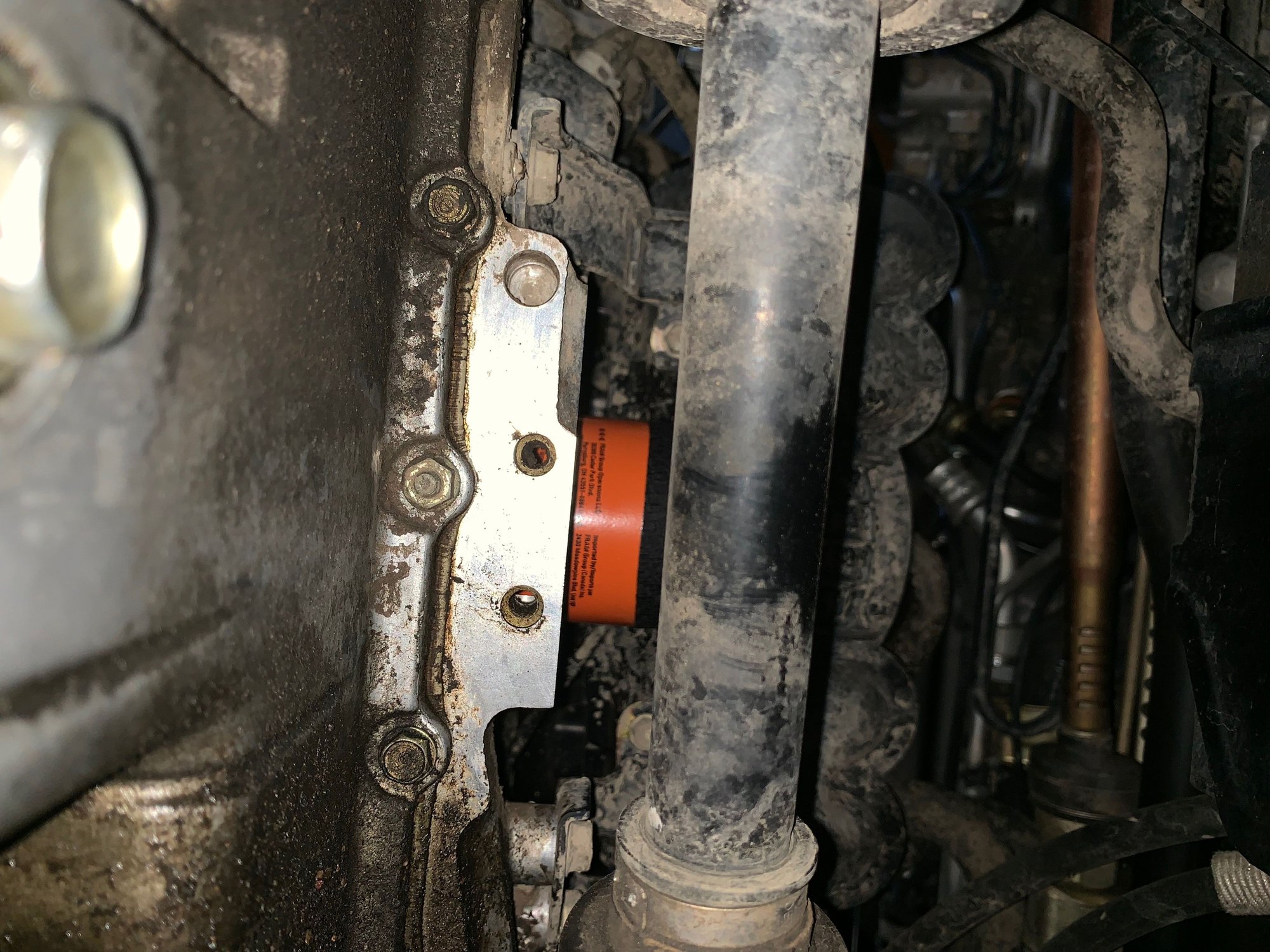

I have a 2004 Honda Civic EX and I have found motor oil leaks in my garage for months already and I thought it is time to take care of it. I can't figure out if the motor oil leaks comes from the oil pan (most of it looks look, just next to the transmission looks wet) or from the part where the crankshaft connects to the transmission.
Please advise based on photos and video attached.

Clean it all up and then drive a little and inspect.
If it still looks like it's coming from the bell housing and engine block mating area, that would most likely be your rear main (crank) seal and you have to drop the transmission at the bare minimum to replace it. It's an expensive job to have done if you are paying a shop.

Thank you for your replies.
I've used the dye to detect the leak and I can see it is coming from the oil drain plug, so I am changing the washer this evening. I can see other places as well. So I am going to start easy and do the more complicated stuff later.
