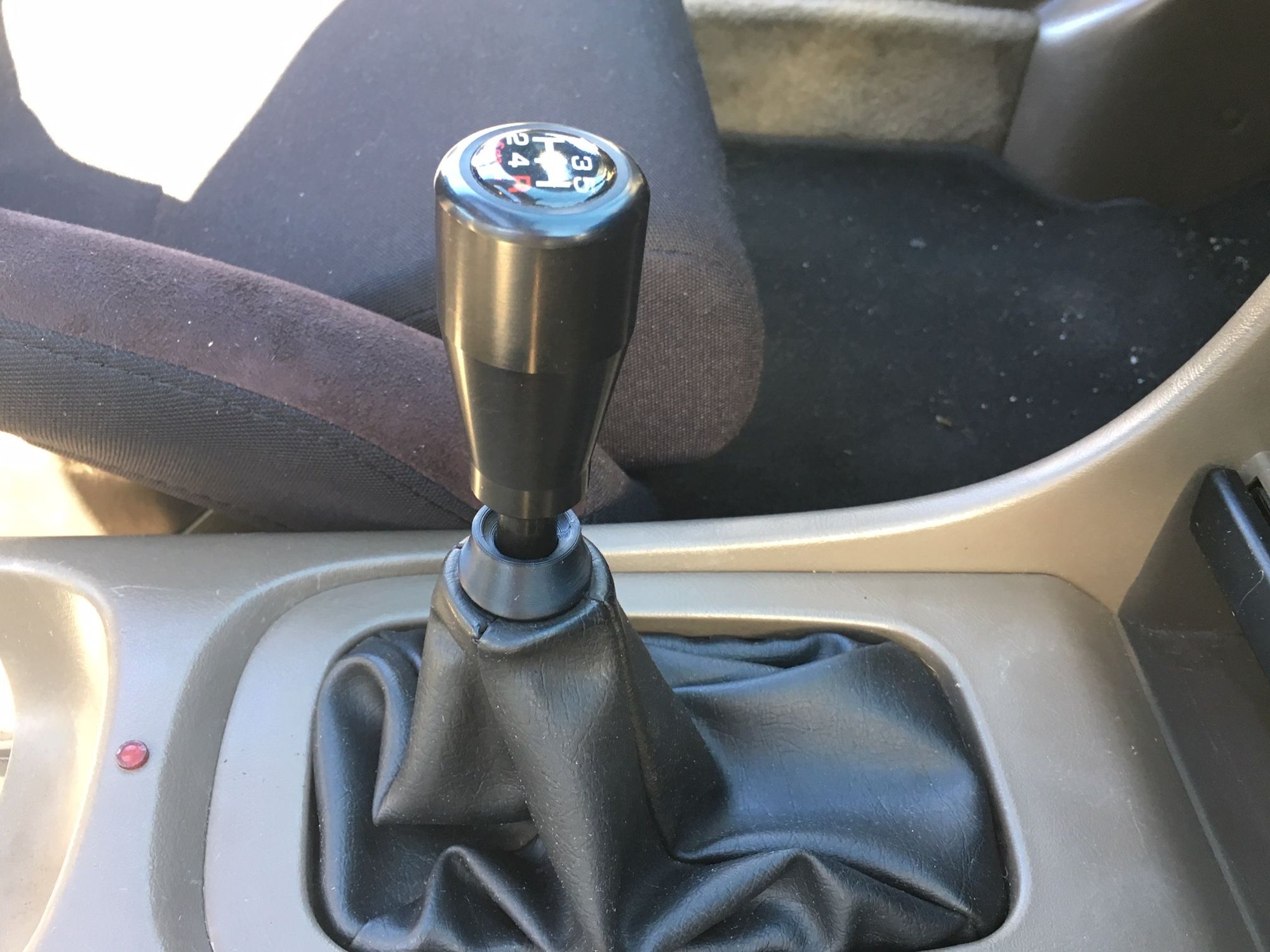

3D Printed Shift Collar
This is designed from ASA plastic. ASA is a better alternative to ABS. It is highly heat resistant and UV resistant. I know our interiors aren't exposed to the sun like our exteriors are, but what's the point of designing something if you don't overengineer the crap out of it??? I designed this to replace the broken OEM shift boot collar, which breaks eventually. I designed it to look cleaner though. It sits 1 cm higher than the OEM piece for a cleaner look. It doesn't look like the shift boot is sagging anymore!

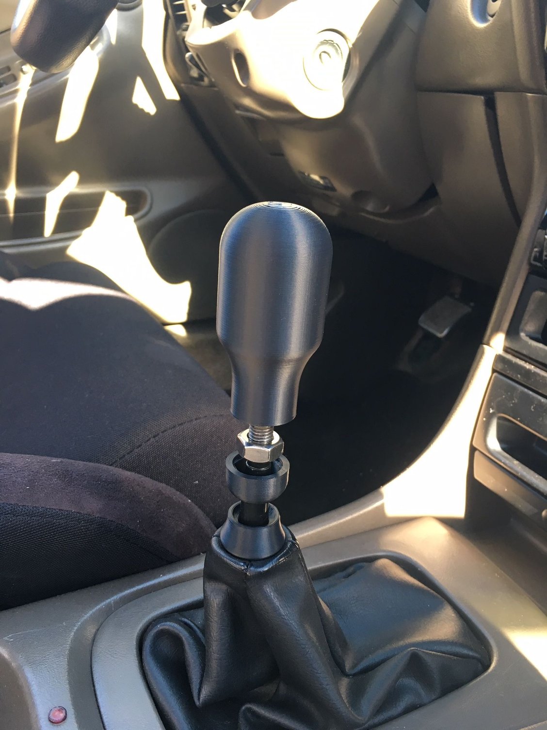

3D Printed 2-Piece Shift **** (Type A)
This is also made of ASA plastic for uber UV resistance, even though it really doesn't need it. It fits perfectly! I printed and designed this thing over and over just to get the fit right! The medial section of your palm fits perfectly along the bottom contour of the shift ****, and the lateral section of your palm and thumb fits perfectly over the gentle curved top end.
I worked really hard on printing and reprinting just to get the finish perfect. Some people like to sand or use chemical reagents to smooth out their 3D printed parts - WHY? I think of 3D printing as an art, so why hide your beautifully tuned print by smoothing out its surface? I wanted to get it perfect and show off the 3D print finish, kind of like how someone would want to show off their carbon fiber parts.
This thing weighs about 100g. I have a stainless steel coupling nut, 45mm in length running through the middle of this thing, which gives it its weight. It feels REALLY solid and the long coupling nut is more than 2x the length of the threads on the shifter. The coupling nut also gives the shift **** its strength. You literally cannot break this thing, even if you lay it on the ground and hit it with a hammer. It will crack, but it won't break from the base!! Because the weight comes from the coupling nut that runs thru the middle, along the axis of the shifter, the FEEL of this is very direct, yet smooth. I dislike heavy ***** because they feel sloppy. This is heavier than the Spoon and Mugen *****, its still 100g, not as heavy as a Skunk 2 ****, but quite hefty - perfect in my opinion.
This is a 2-piece design. The **** utilizes a lock nut to hold it in place. There's a 2nd piece that slips over the locking nut, and gives a clean, slick look!
