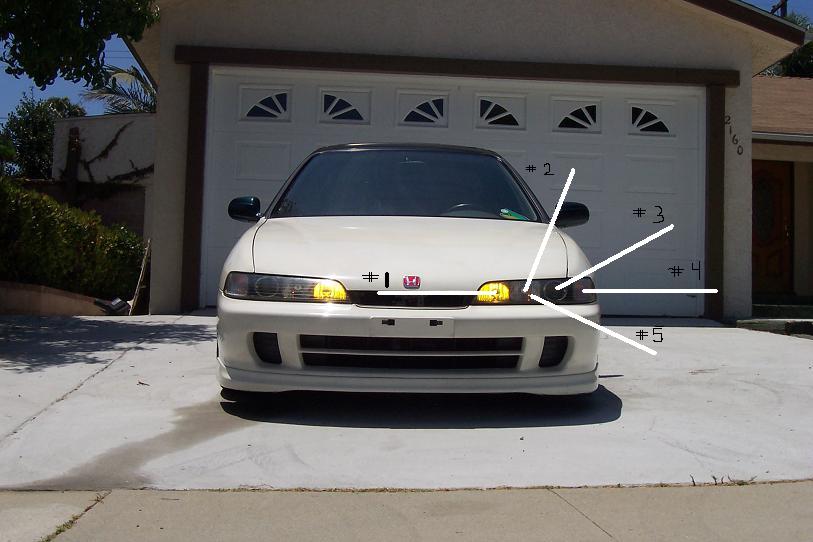

Ok i need to replace the bulbs on my integra.. i have the jdm conversion front and would like to know what bulbs i need..
Whats are the bulb numbers for #1,#2,#3,#4,#5
thanks.

Well, its all writen on the headlamp inside.
# 1> h3
#2> h1
#3>9006
#4>1156
#5>W5W

thanks man...i did a search but every other thread had something different..
