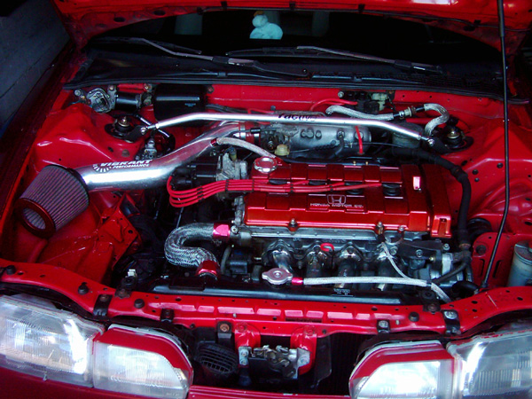

Heres my f#*$ up lookin engine bay, what can I do to make it look better, besides painting the valve cover and probably ss header with out the heatshield. What do I do with the cluster of **** around the brake booster area? Oh and all the red hoses and coupling will have to go also!

you can ditch the ABS setup for pretty cheap usually I did my old one for about 80 bux including 3 stainless lines. also clean it and pick up a AEBS IM for it or S2 for a lil less power but cleaner look. also the coolant lines that run through the TB and IACV can all be deleted. Move the battery into the trunk. Pull the fenders and rerun the wires for the headlights ect. Also pull your mounts and have them repowdercoated black . Run your ground from the back of the valvecover along another line. Also ditch the oil cap for a stock one, put your wire cover back on an repaint your valvecover as stripping it will blead heat into the engine bay. also get some stock black spark plug wires.
check g2ic.com for details
