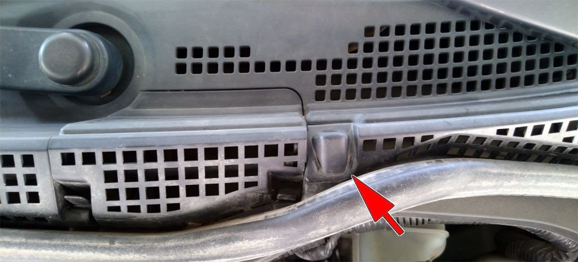

Hello,
I have a 2005 Accord EX. the windshield washer nozzle on the drivers side doesn't work (no water comes out at all) the one at the passengers side works just fine. I tried poking it with a needle but nothing happened. and as i don't have anything i could use to blow pressurized air into it or anything, i thought I'd remove it and check the tube and all that, but the problem is that i can't see a clear way of doing that. the nozzle is built right into the plastic frame, do i really need to remove the whole frame just to check the nozzle and tube? If so, how do i even do that? i have no idea. any thoughts?
I've attached a photo for reference.?

Re: How to remove 2005 Accord windshield washer nozzles?
the washer nozzle is not part of the cowl. just find yourself a small flat head screw driver and gently pry on the edges. you can also remove that piece of cover next to it and use plyers to grab the tabs and put the nozzle out
