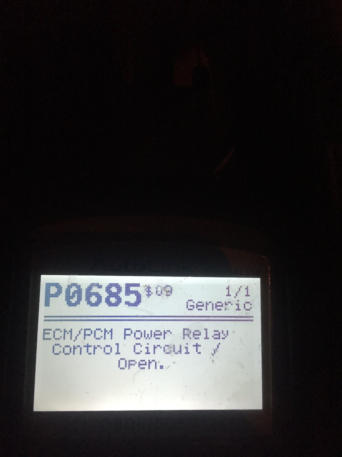

my car 03 Honda Accord has the same problem; when i drive the Green light for D disappears for 3 seconds & the check engine light trys to appear but just Blink & go away. & loose power, & all the lights on the dashboard start coming on & the radio lose power & then the car starts by itself again. & sometimes I shut off & i have to started. Until now give me the code p0685 ECM/PCM power relay. & I dont what step to take now to fix it cuz it could be a lot causes.
