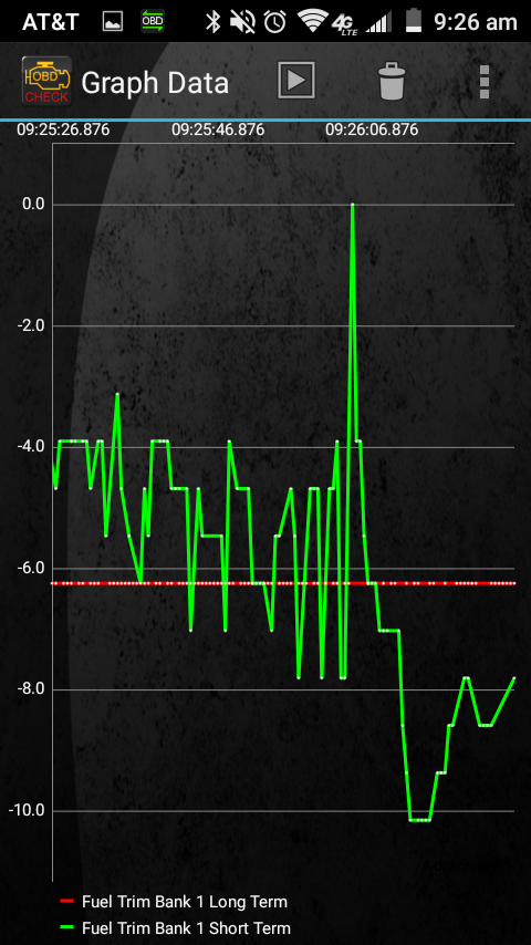

Thank you for your insight. I used my brothers scanner and took a short trip going about 30-40MPH to the grocery store and back home going 15-25MPH.
Here are my results:
30-45MPH
15-25MPH
According to my calculations and personal research, my engine seems to be running rich since its hitting the low 20's negatively, but I am not that mechanically inclined so I do not know if this is normal for Accords or not.
If it isn't, then I will follow MAD_MIKE's prognosis:
