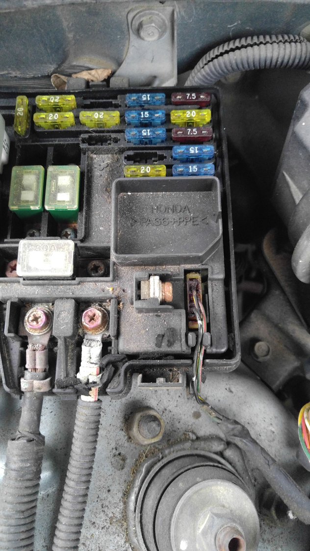

Does anyone know exactly what the plug/clip/connector is for at the bottom right of the fuse box?
Background info.. Not really needed, just here for those who are interested... I'm having the intermitten starting issues, that I believe is caused by the ecu getting moisture in/on it. Fuel pump and relay both operate fine when the ecu let's them. The trouble happens after it rains and tends to hang around for a few days. Once it's dried up outside, I have no problem what so ever. I've read a few forums, including one in h-t I think, that people have fixed the problem by replacing ecu. I took a look under the hood and found the slightly melted or just really discolored connector. I can't find any real info on it. I'm wondering if it has anything to do with ecu and/or fuel system. Could it be what is getting the moisture and causing the ecu to act up? Sorry for being long winded. I'm not a huge fan of dropping money on a big ticket item, unless I'm positive that will fix problem.

That's the eld connector and it definitely isn't the cause of your issues. It's job is to detect how much amperage is going through the fuse box and to tell the alternator whether to charge in low output or high output. I suppose it's possible that the ecu is having issues. It's more likely either the icm or the ignition coil are bad. It's even possible the gasket for the distributor cap is so severely worn that's letting in moisture. When it's having issues starting(assuming it is cranking), it would be wise to check for spark.

Sorry it was a typo. It was suppose to read "eld connector" not "ecu connector".
