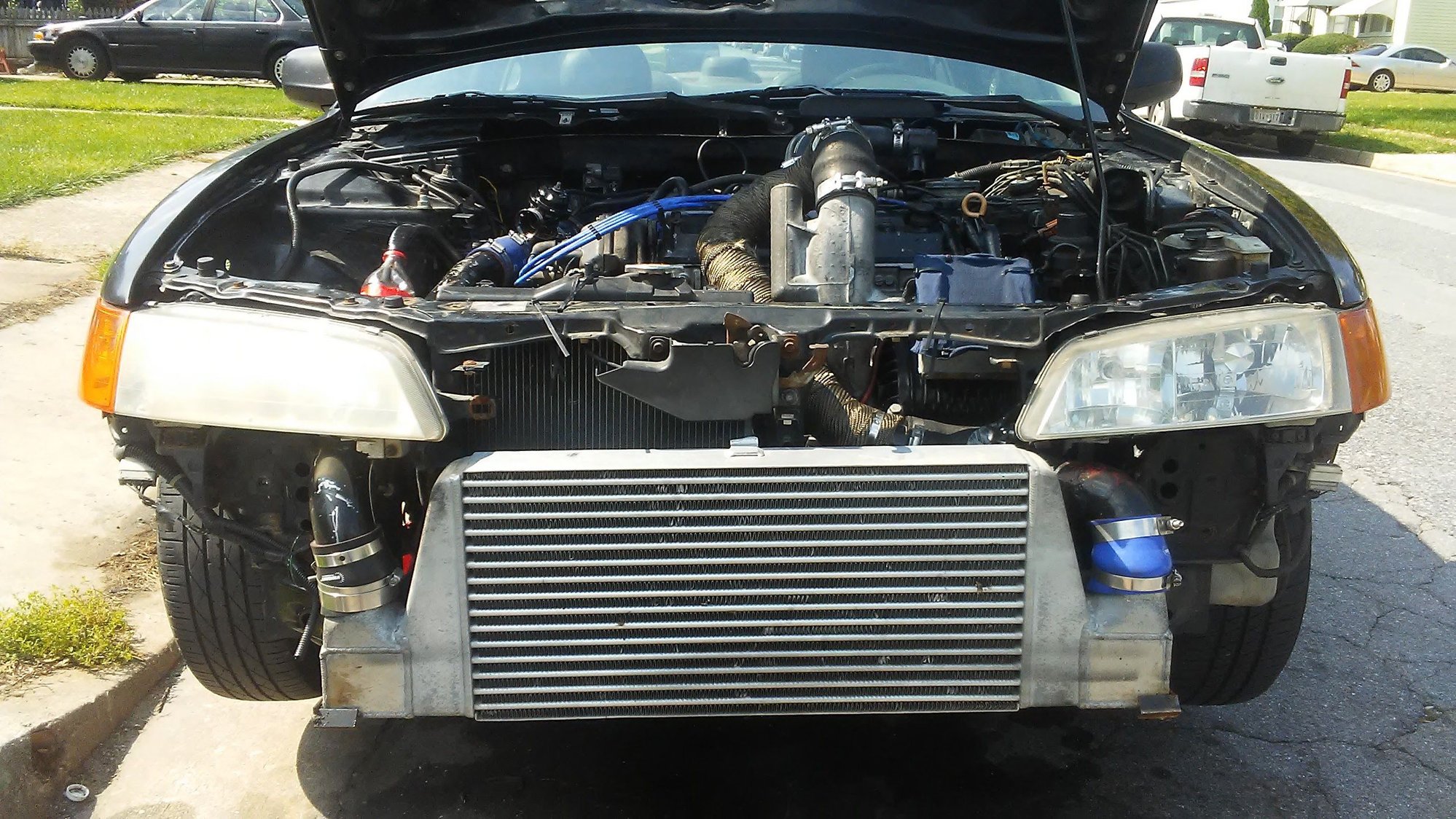

Updated pictures from this morning of lower plenum, blower mounting, belt routing, exhaust setup. Exhaust is 2.5 stainless with 3 resonators (2 vibrant, 1 magnaflow). The rear foot is 3 inch due to that being the only leftover resonator and perfect turn down. Almost every part on this car is from my local "crazy rays" salvage yard.

Back together. As you can tell, I could care less of how it looks. The car is a junkyard build after all. There is so little room to work up front. I had to use a 97 or so civic half radiator due to the blower being all in the way of everything. The car definitely feels much smoother and powerful when WOT. The power feels more linear. As I type this I realize I didn't even activate vtec in the controller.... I attempted a vtec killer setup before teardown and hated the low end power loss. I had to add 4% fuel across the board as well (badass)

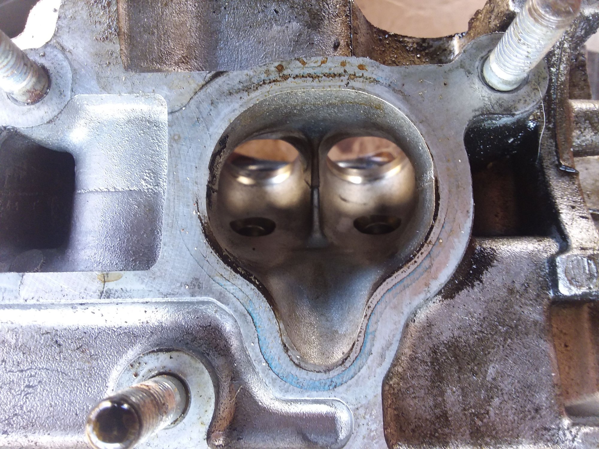

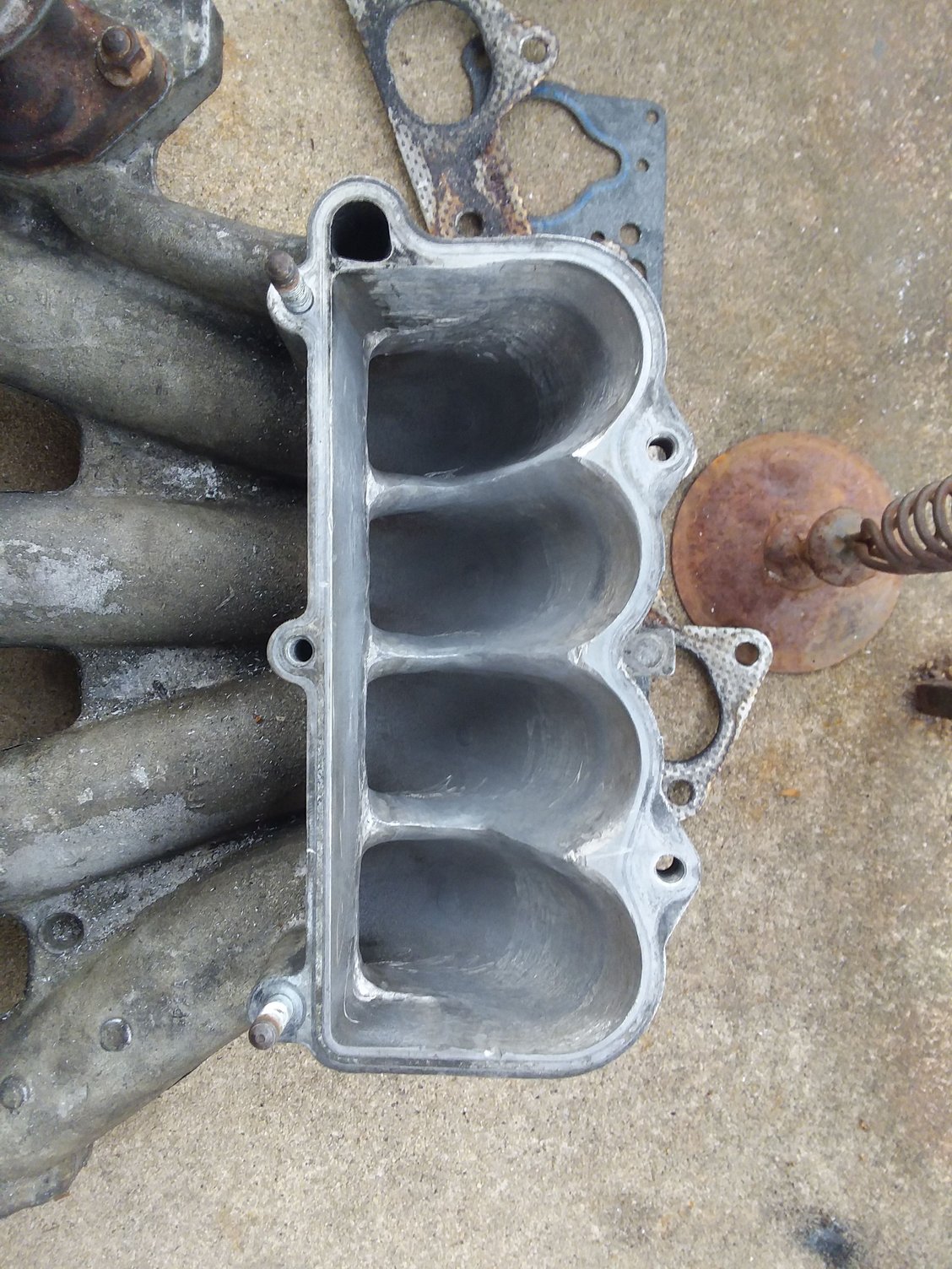

prior to port and polish head, intake manifold, and blower. What a difference in immediate response and power delivery.
