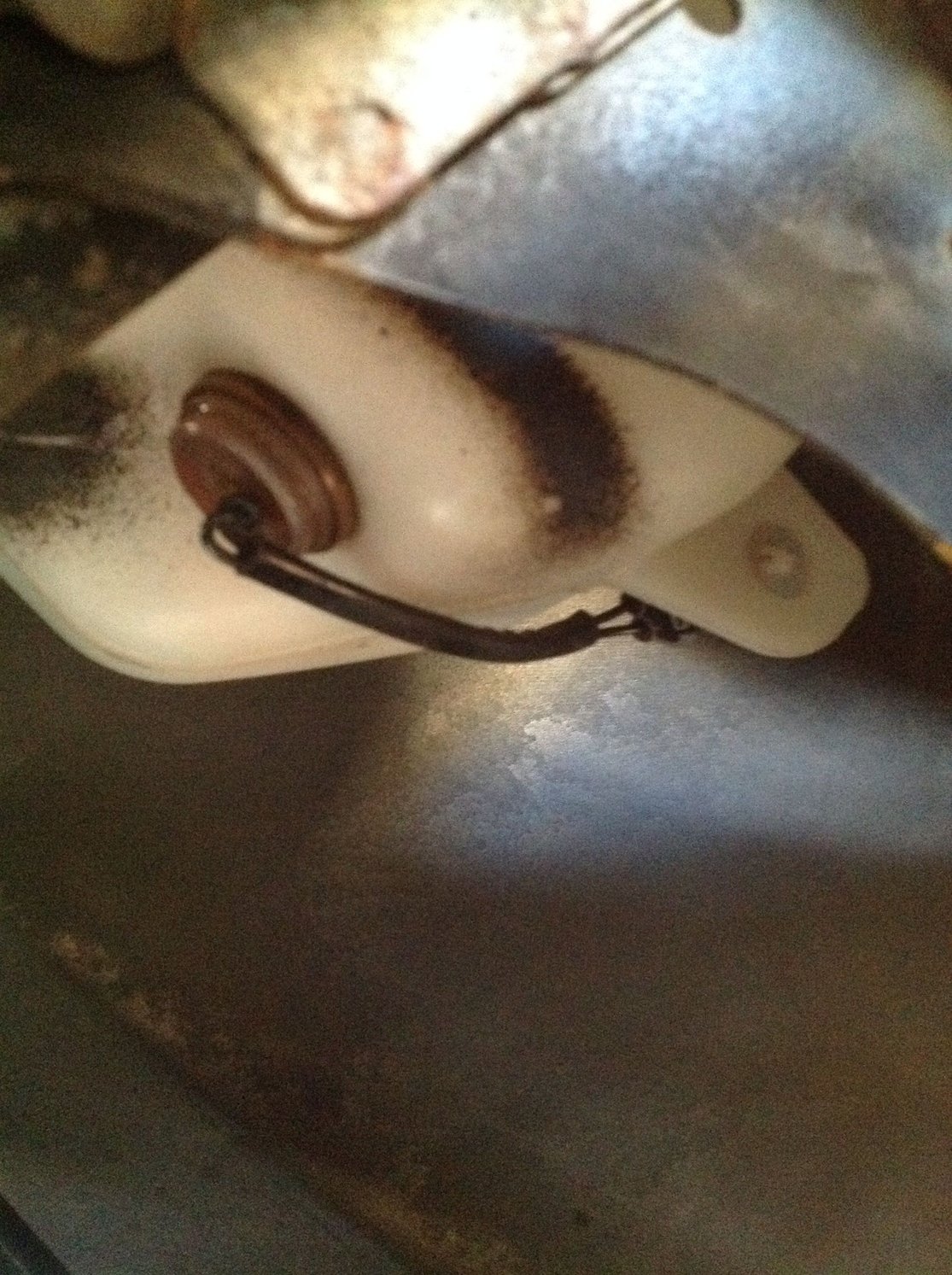

What is this part called? The washer fluid reservoir is leaking from here. I don't. Know if it just the seal. It has two wires, so I suspect that it tell the car when the fluid level is low. What can I do to fix it? Glue it?
