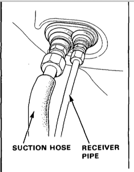

Well I am beating myself for not reading this before...I got my hands into it I am in the middle of a big mess. I finally Got the two nuts off ( 24 and 27 mm )
I was thinking of replacing as many o-rings as possible and leave it alone. Then I decide to take out the evaporator to clean everything out.
I took all the nuts off , AC band, So the evaporator is lose. But I don't see how I can pull it out. Even the dashboard doesn't allow it. In other words, it is not as easy as the manual says :/
EDIT: I am such an idiot. I was trying to pry off the fan instead of the evaporator. I couldn't do anything else and went back And corrected the problem. Once I took the evaporator out, I could put back the fan ....
I tried and blew air... I was asking the new and the old gods I didn;t break anything in this process. And it worked.
I will post pictures later so you guys advice me what to do...

Update:
This is how the evaporator looks like:
The stuff around the expansion valve looks like oil.
How do I test the expansion valve?
I must say I blow air and there is no resistance to it . It passes through
Re: A/C system holds pressure, no leaks, it doesn't cool down
It's actually a good thing you pulled out the evaporator because as you can see the expansion valve is leaking and that evap core is caked up with crud. You can just imagine blowing air across that crud and it blowing into the vents and into your face. You can clean off that one or just get another. I would get another since you can't tell if that core is leaking as well or possibly its just the orings leaking in that area.
Replace the valve, it is only $16.95 from Performance Rad... https://shop.performanceradiator.com...39_20268_20269
Replace any/all O rings of connections you have undone, DO NOT reuse O rings, they will leak.
Do not forget to oil, [C4 oil is best, but Ester oil will work] the O rings as you install them and keep everything clean, even a spec of dust can be a problem. 94
