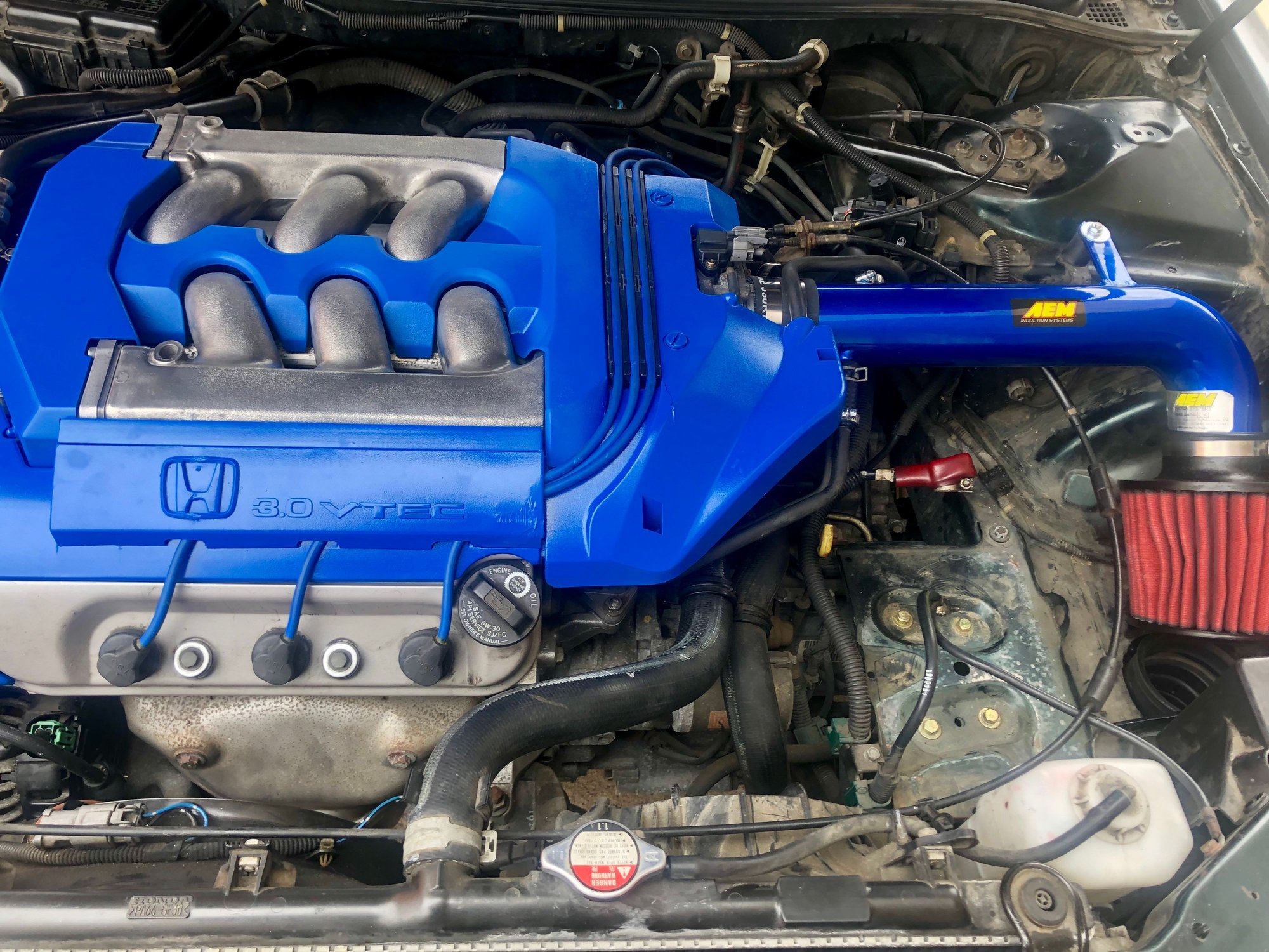

Changed the fuel injectors, fuel regulators, fuel relay, fuel pump , after no start first checked relay it was fine. I could hear the fuel pump buz when turn key. I took exhaust manifold off Checked the fuel lines unplaced from regulator no fuel getting to fuel rail or regulator. Do you think the Fuel pump is not working. When I installed it I had to wire the harness because the universal pump didn’t have the clip connected that fit Honda. So I put tabs on each wire and plugged into harness that way. Is it possible the pump could be in reversed? Maybe I put the Wires in wrong due to different color than OEM. I already replaced ignition, plugs and wire , rotor and cap, cleaned out the throttle it had built up carbon as did EGR replaced and cleaned out manifold that was plugged up. I also replaced catalytic converter it was clogged. Turned black from leak due to clog. Replace charcoal canister and shut off , replaced map , purge control solenoid , crank sensor , fuel air sensor , vapor sensor , idle air control ,
Replacing fuel injectors and Regulator here and cleaning manifold and throttle
Plugged catalytic converter
Back together with new air due to my oem box broken up and battery box cracked as well.
