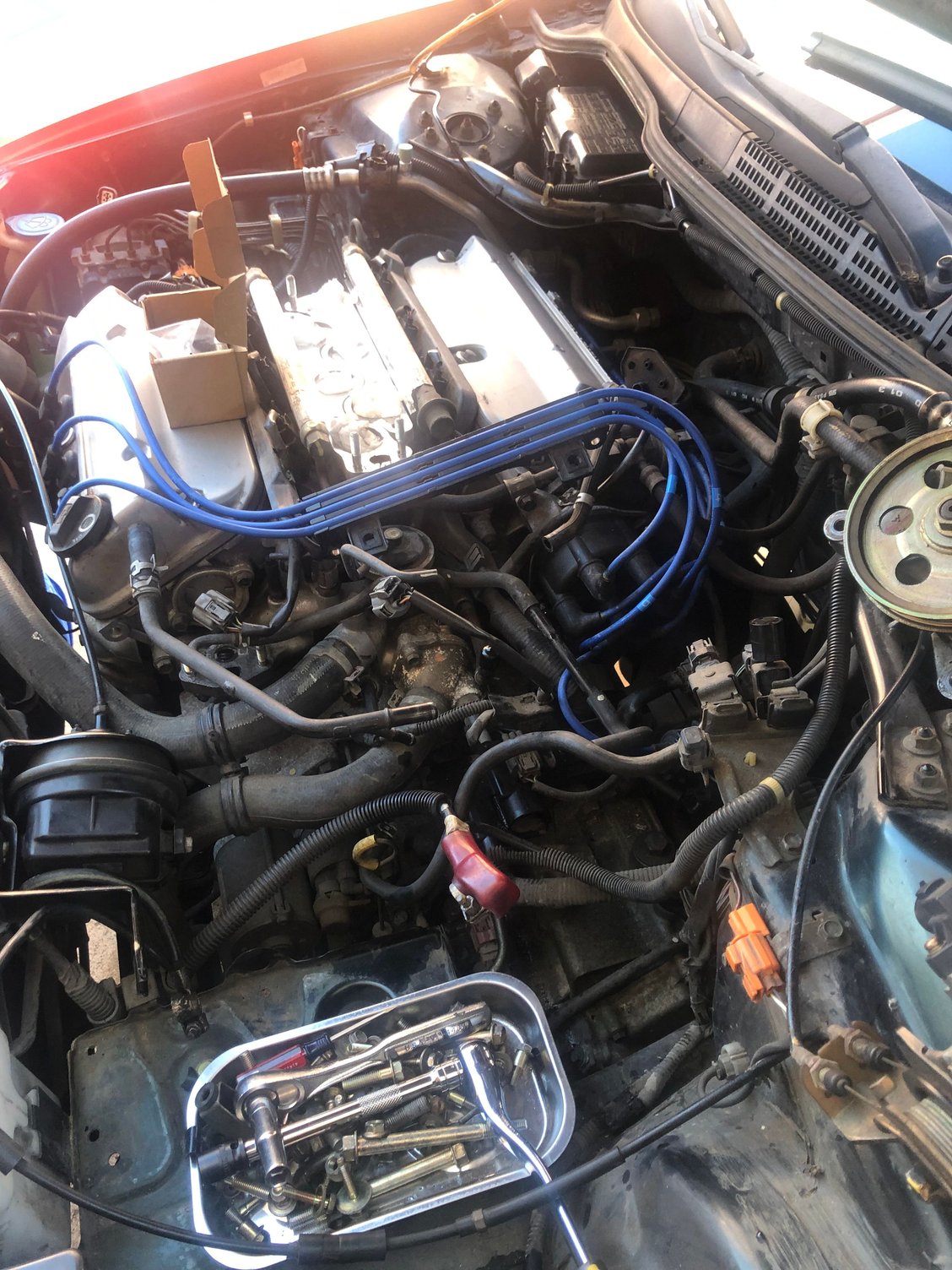

This far the new Bosch battery sits in garage. I’ve decided to replace as much as I could on my 98 V6 Coupe. Starting with timing belt , pulleys , tensioner, serpentine belts , water pump, plugs NGK Laser Platinum PZFR5F-11 -OEM , NGK Wires, rotor and cal, Ignition , Map sensor , fuel air sensor , EGR valve , shut off valve , charcoal canister, fuel pressure regulator, heat sensor, power window , intake AEM, fuel injectors OEM, oxygen sensor both , catalytic converter , idle air control valve, right engine mount , hood shocks, crank sensor , door lock actuators, throttle sensor, fuel pump, cleaned exhaust manifold, throttle body, oil HONDA : power steering , motor , trans , new wipers , . Coolant , and I still have to paint it after I sand a the clear coat that is peeling off. 132000 original miles
Before I put belt back
Cleaning throttle and ding installs
