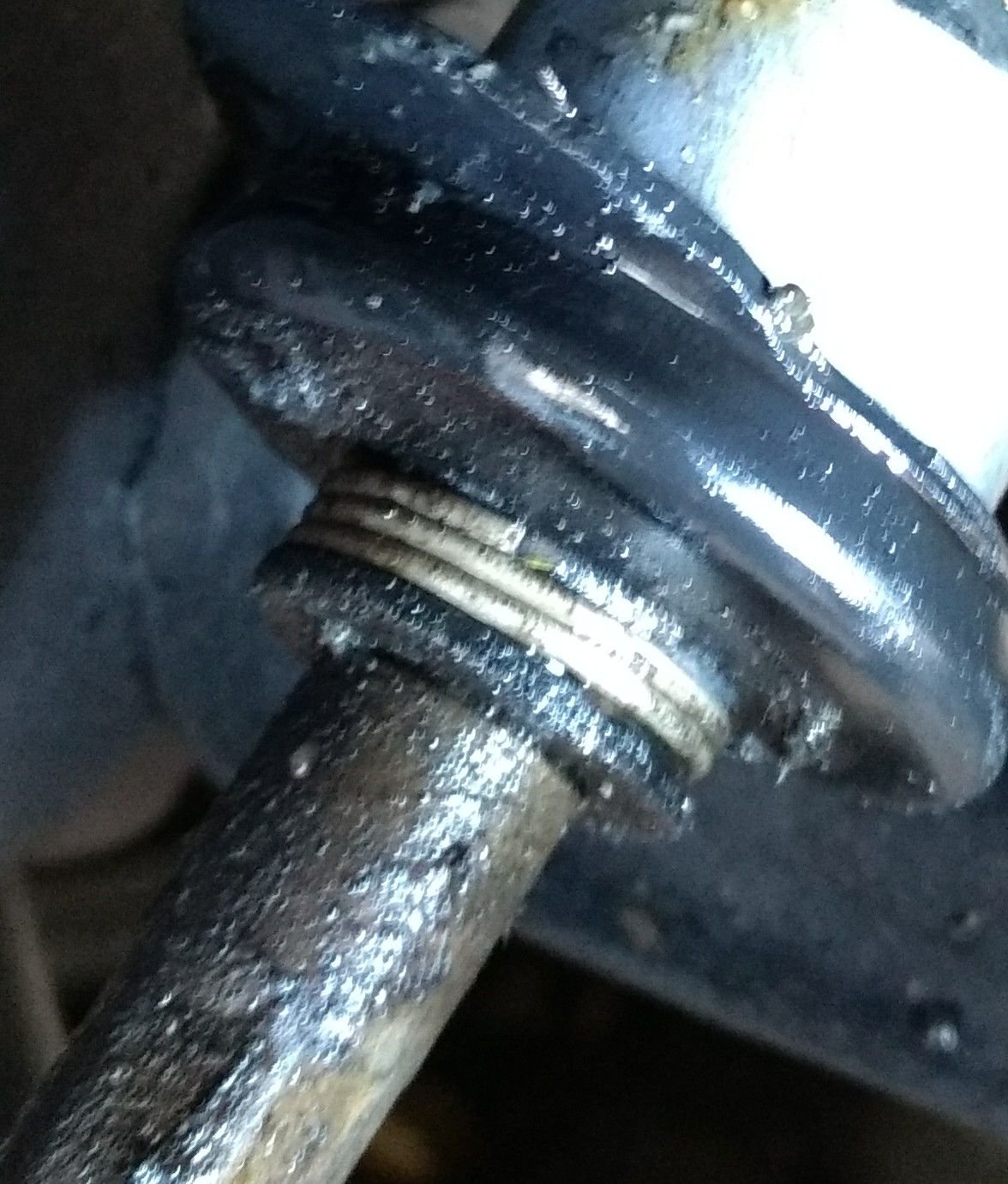

The first thing I did was passenger side check. I had a standing jack in place raised just high enough for the tire to be off ground.
Then I tugged right to left and top to bottom as I saw in the video and it was pretty tight, nothing felt loose.
I to a pry bar and tested the lower ball joint and didnt see any movement. The boot looked to be ok as well.
But the upper boot looks dry rotted and cracked.

The there was this! A boot that just separated and got mangled. Can these boots be replaced? Or is it the whole assembly? The other side didnt look right either.

Then I thought to replace the inner and outer tie rods.
Here are a couple of videos I watched on that
But what none of them covered was the lock washer on the inner tie rod. More on that in a minute.
The outer tie rod was pretty simple. Loosed it up and counted the rotations off the inner tie rod for reinstall of the new part.
Then came the inner tie rod, and after searching the local auto part stores for a tie rod removal tool for a 96 accord turned out to be a bust so I started a thread and got some help from Mad Mike
https://honda-tech.com/forums/honda-...l-buy-3331060/
I had to first pound back the lock washer with a screwdriver at a few different angles
and then do this
