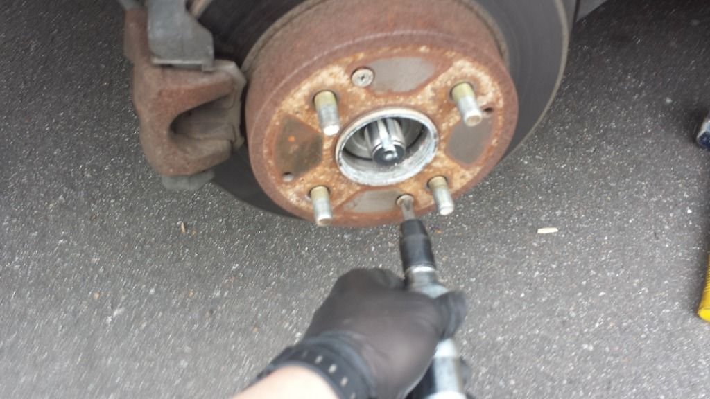

The screws holding the rotor onto the hub are a pain. I've only been able to do it with an impact driver. Make sure you use a bit that completely fills the head of the screw or you are much more likely to strip it. Set the impact driver and give it a couple good whacks with a hammer and it should do it. If not it'll strip the screw. I've had to drill a couple out of an old Civic I used to have and it was no fun. Luckily I had no trouble with any of the four on the Accord here.

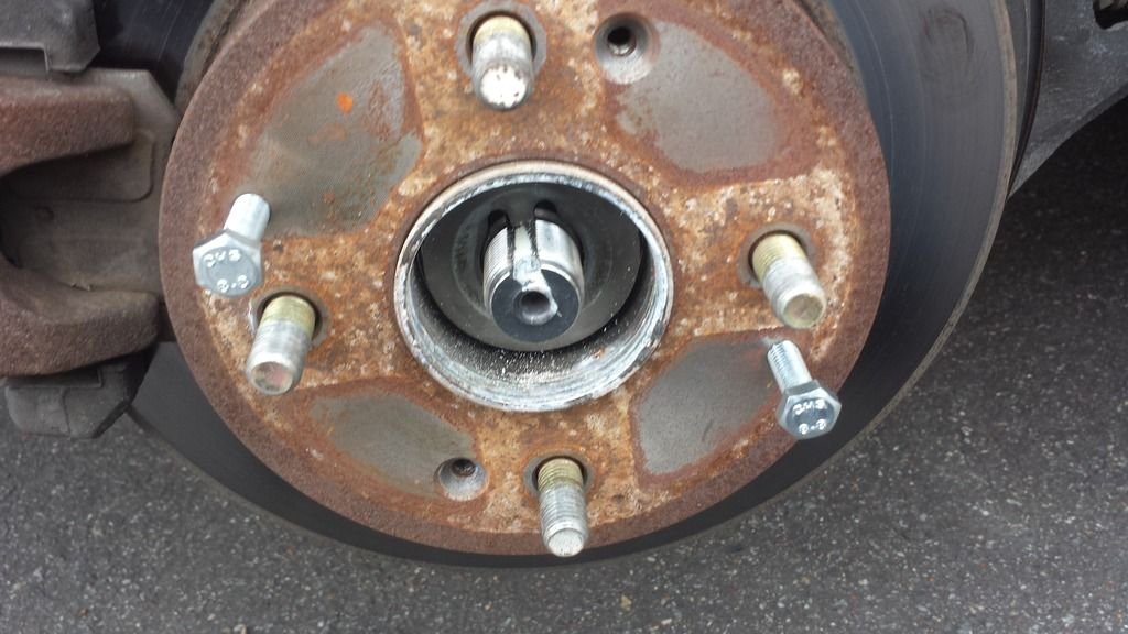

This step might not be necessary if your rotor is easily loosened. Using two 8 x 1.25mm pitch bolts at least 25mm long, screw them into the two screw holes in the rotor that you did not just remove screws from. Tighten them slowly alternating one turn at a time to push the rotor away from the hub. Remove the rotor.

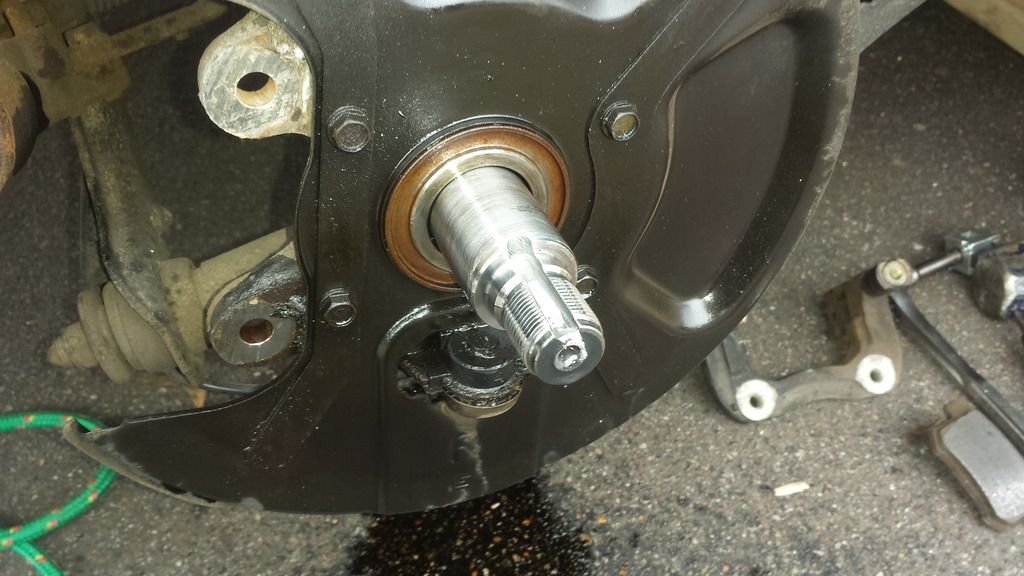

At this point you should be able to wiggle and work the hub/bearing off. Note the washer on the outside of the hub. You will be reusing this.
Clean the spindle off with a light sanding and brake cleaner.
Make sure your new hub/bearing has the ABS ring on it and generally looks the same.

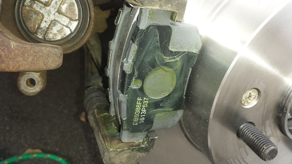

Select the pads that match the ones you took off. Make sure the inside one has the tab sticking out on the same side.
Using brake grease lube the backs of the brake pads and the exposed surface of the new clips in the brake caliper bracket that will hold the pads.
don't get any grease on the rotor. Place the pads in the caliper bracket. The pad with the metal tab sticking out goes on the inside.

As to removing the screws that hold the rotors to the hubs, if you use JIS driver instead of a Phillips it will go much easier.
