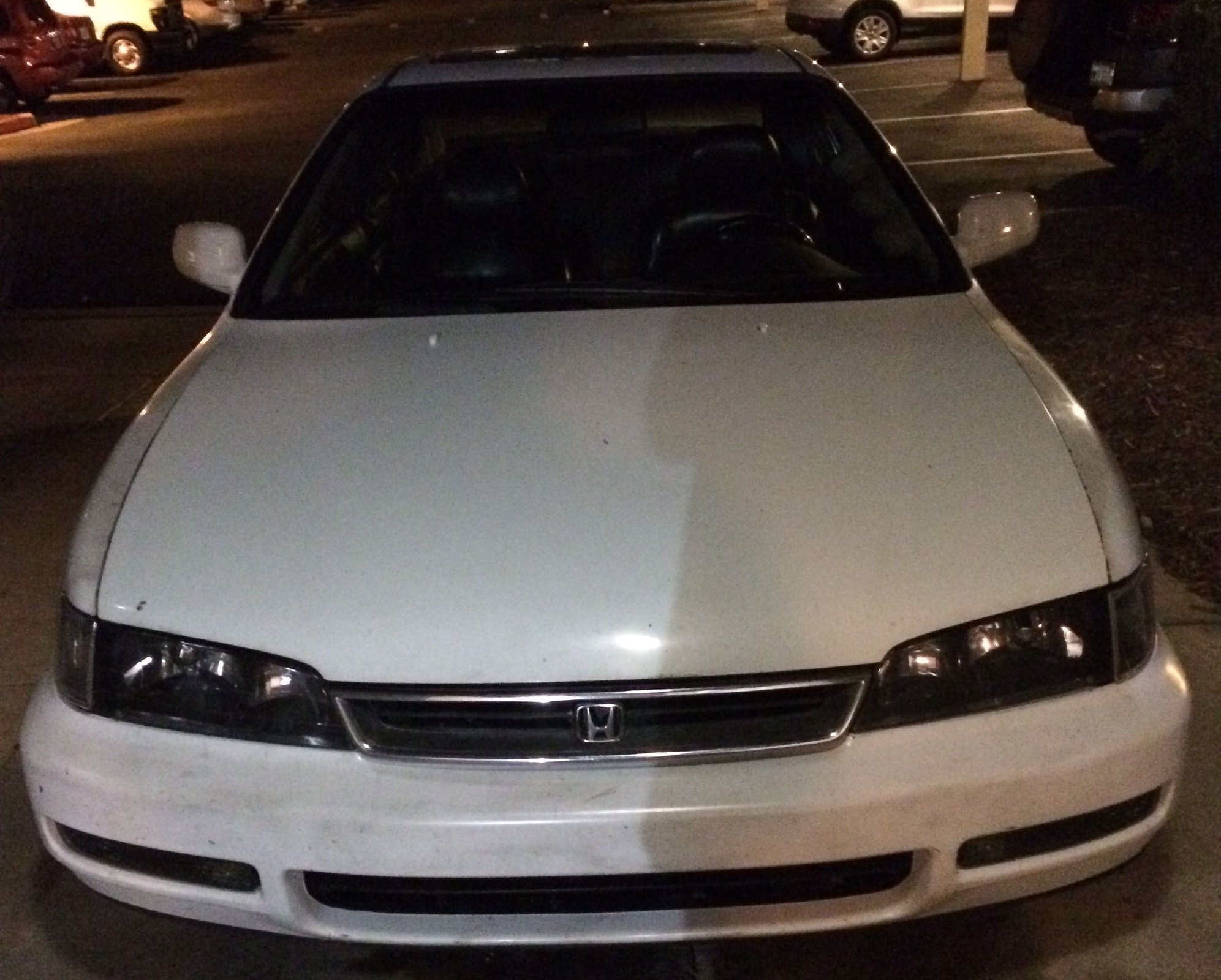

Got the car for $1700 a few years back and it was in pretty bad shape. Its been a Daily Driver project. I have scrubbed the engine bay multiple times but i think the old paint just keeps everything. Pictures were just taken at night so everything looks dirtier, i think. Been upgrading whenever doing maintenance. Optima battery is out at the moment, my alternator was toast and i threw in a cheap walmart battery get the car home and get the battery tested. Grounding kit connects from the battery to the main engine ground and then to the Valve cover. The upper left wire is off because i didnt put if back on after the manifold upgrade.
