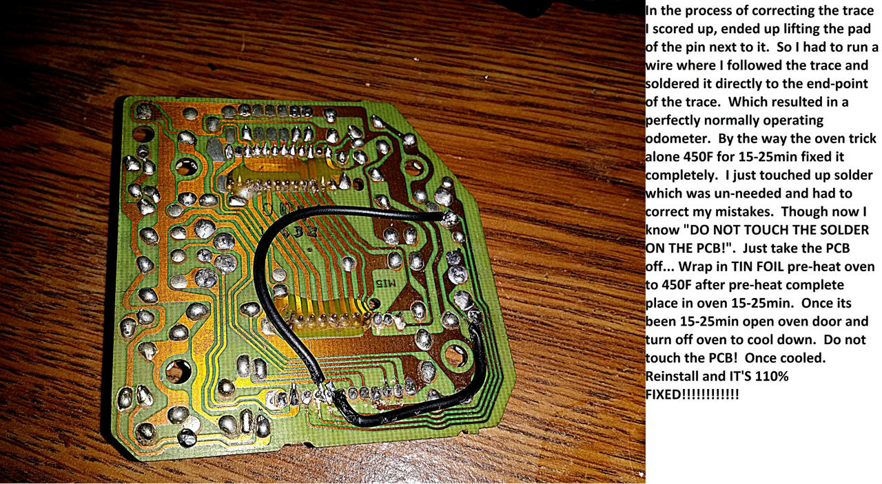

I did basically this and it worked for a month and then had problems again, eventually swapped in a used pcb from another cluster that never gave me a problem again in 40k til I wrecked the car
