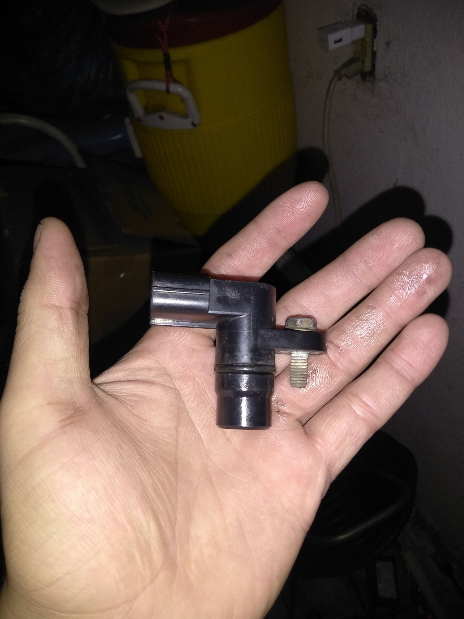

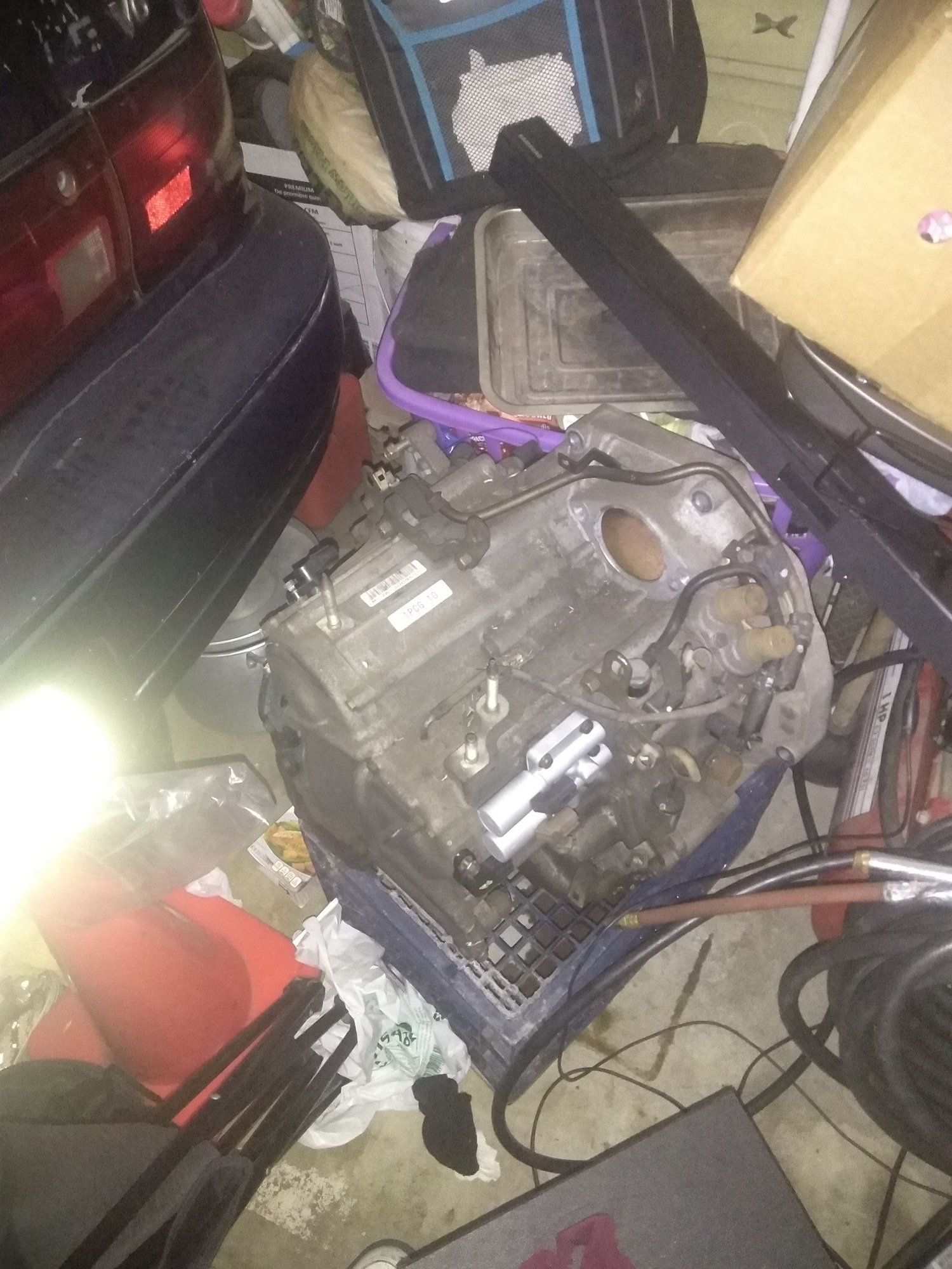

Can someone identify these for me it on
There this one and one on top
The two black sensors one on top and one on the side
​​​​​​a 2000 Honda Accord LX

I believe both are transmission shaft speed sensors used in the control of the shift logic.
https://www.hondaautomotiveparts.com...ensor-solenoid
#14 Top sensor is Pick-Up Assembly, Main (Tec) 28810-P4V-003
#15 Lower sensor is Pick-Up Assembly (Tec) 28810-P6H-004

Jose and noemi@ It is a transmission shaft speed sensor.
