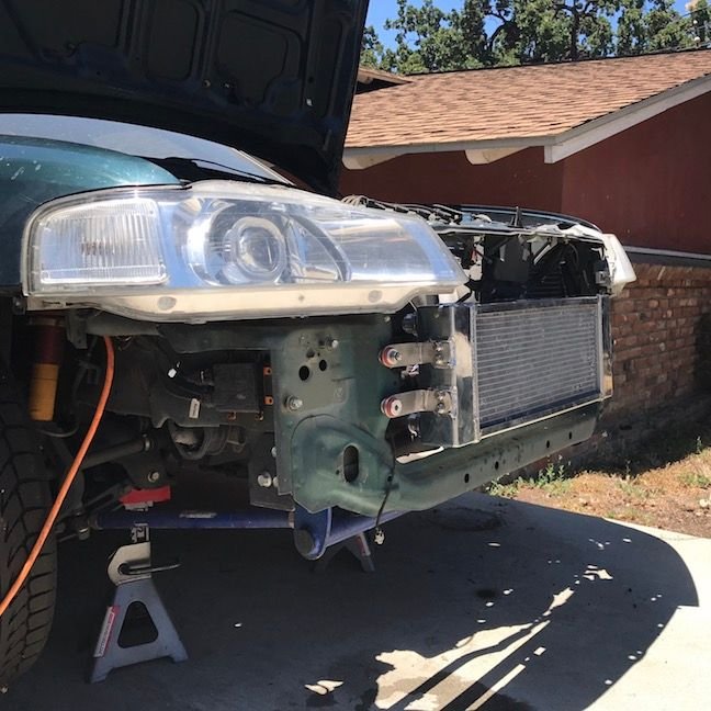

Well...I got bored on Saturday and felt like getting a sunburn, so this happened.
Pictured above is a Rywire tuck radiator. It's the smaller offering because the big one wasn't available when this one was purchased. If need be, i'll upgrade to the taller one, but it would require a little cutting and welding on the core support which I didn't want to do. The Rywire radiators only come with 2 brackets, so 4 new ones were bent up for me. A washer was welded to the back side to make it a bit thicker at the end of the mounting tabs. We used silicone and billet mounts to help isolate from vibration, and I spent way too much on bolts to put it all together, because ARP stainless is required for all things not OEM, right?!? Anywho...baby steps.
Yeah...there is still a motor in it because I've been mopey and lazy; however, now that it is on stands, I am going to start disconnecting systems. The shifter assembly is coming out this weekend, and i'll probably break loose the fuel line and pump the tank dry. As soon as it's ready to pull i'm gonna call in the picker, and yank that little bastard out. #finallyfeelingmotivated

Was gonna ask why you didn't mount it on the inside but I see the condenser is still there. Nice.
Surprise the engine is still in your car...damn...other member didn't come through on helping with removal?
